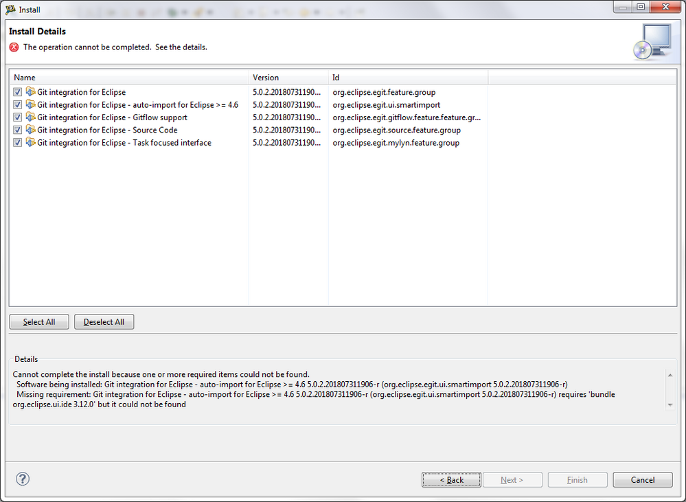

Hi Support Team,
I want to install GIT for Code Warrior Development Studio but failed.
Can someone help me with this issue? Thanks.
Bruce

Carlos_Mendoza
Hi Bruce,
I think that the following post created by our colleague Erich Styger might be helpful for you, the error you get seems to be related with the eclipse version being used by CodeWarrior:
Installing eGit in Eclipse and CodeWarrior for MCU10.4 | MCU on Eclipse
Hope it helps!
Carlos Mendoza

jinliangsun
Hi Carlos,
Thanks for your answer. I installed the eGIT successfully. Thank you for your help.
Bruce
