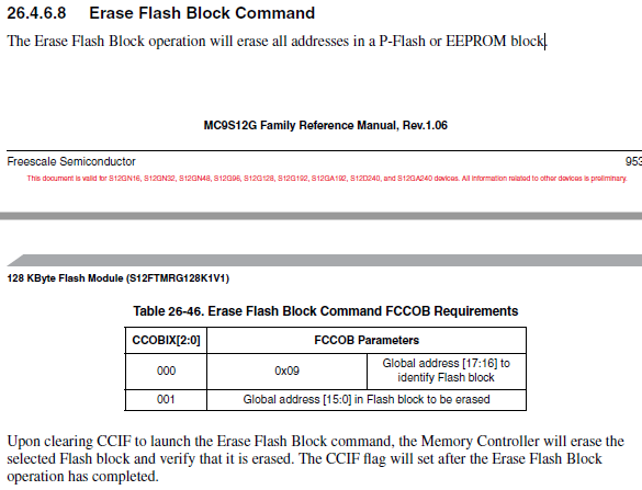

 hello:
  Development Environment :  MCU --- mc9s12g128     IDE --- codewarrior 5.9.0
  1. Erase eeprom block command code relocate to the RAM.
  2. datasheet description
  3. full run is error , note ILLEGAL_BP ,  why?
1,297 Views
ZhangJennie
It is not possible to read from EEPROM memory while a command is executing on P-Flash memory.
Please refer GN32-EEPROM-EW-CW51
S12G Examples Pack
GN32-EEPROM-EW-CW51 is the example code made for S12GN32 device with 1KB of EEPROM.
You can see in the main the EEPROM_END  is defined as 0x0007FF. You can re-use this code on S12G128, just change the end value of EEPROM to 0x13FF.
