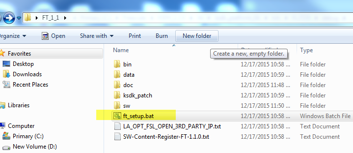

I just tested ..FT_1_1\sw\examples\frdm_aslider_app demo code included under   NXP Touch Software Library v1.1   from my side under kds3.0. now it can pass build and run well from my side on FRDM_KL25 board. see attached video
please check below points:
1. make sure you run ft_setup.bat to install the necessary files to ksdk install folder
2. rebuild lib C:\Freescale\KSDK_1.2.0\lib\ksdk_platform_lib\kds\KL25Z4
3. open project for example ..FT_1_1\sw\examples\frdm_aslider_app
in project properties, C/C++build, settings, Cross ARM C Compiler, Includes, make sure you have all the related KSDK source/inc folder included.
4, check project properties, Resource, Linked Resources, linked resources tab, make sure all the related resource locations are correct.

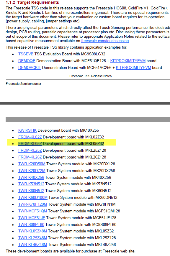

Hi Suresh Jaggal
you can download and use:
Touch Sensing Software Suite installer Version 3.1.0
The Freescale TSS code in this release supports the Freescale HCS08, ColdFire V1, ColdFire+, Kinetis K and Kinetis L families of microcontrollers in general.
FRDM-KL05Z is also supported in this package.
can this help you?

Hi Suresh Jaggal,
