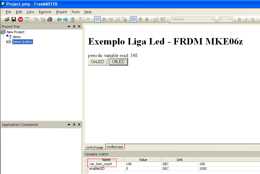

                Is it possible to execute a VBS script with reference to FreeMASTER's invisible ActiveX control OUTSIDE of FreeMaster? I want to to execute FreeMASTER commands from the command line just by executing VBS scripts.

1 - Run the project in freeMaster
2 - Create .vbs file in the work area as follows:
Option Explicit
'On Error Resume Next
Dim FMObj
Dim succ
Dim tValue
Dim vValue
Dim bsRetMsg
tValue = 0
Set FMObj = CreateObject("MCB.PCM")
succ = FMObj.ReadVariable("var_test_count", vValue, tValue, bsRetMsg)
WScript.Echo tValue
WScript.Quit
In my case saved as teste.vbs
Note that this very similar to yours.
3 - Run the .vbs file and in my case the result was:
See if that helps.
