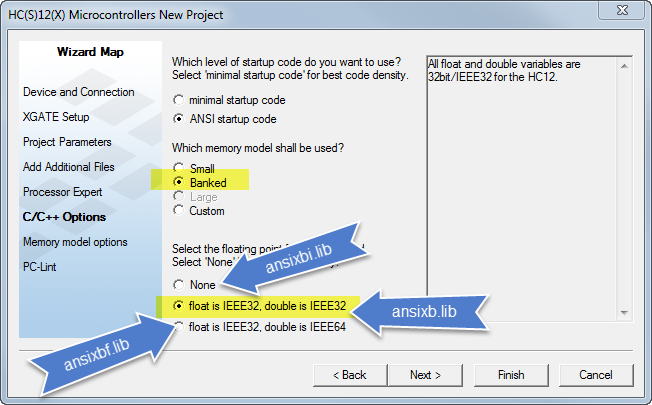

i found in my project that floating point calculations are not supported as it was not compiling and i changed it by making it integer division and multiplication. Now my doubt is if i return the values as float and do multiplication and division something like i am doing at run time. How does the compiler handle this? Will i get something like segmentation fault and the processor will reset? Related question is if i add the floating computation. How much additional code will get added by adding all the libraries? Please help. I am using s12x.

hi,
floating computation need floating lib support. when we select different floating support during creating a new project, we  select the different lib supporting for the project.
when floating library is selected, user can do floating computation in project normally .
see my post

can this help you?
