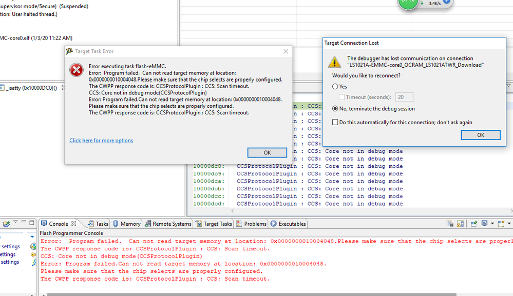

When I use CodeWarrior to flash my stand alone ls1021a which has external eMMC
I encountered this error below:
Anyone knows what is going on ?

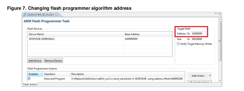

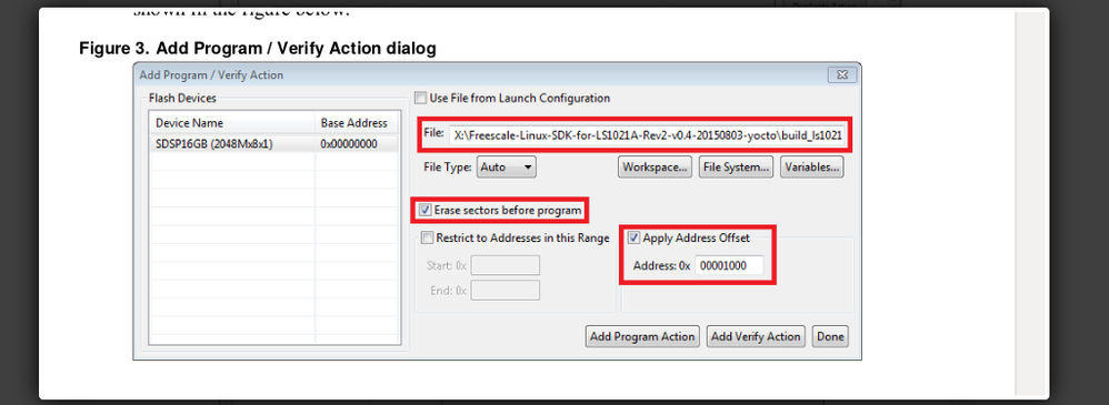

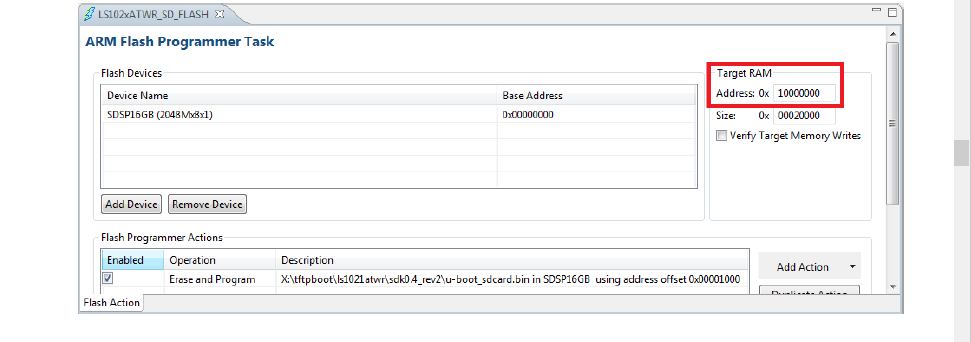

first of all that document is exactly what I followed. I used these step to create a emmc-clone.bin and emmc-clone.img
(1) can you tell me what is the right value for this I suppose to put
(2)I am doing via OCRAM my image size is 1.2 GB. Should I still put the 0x10000000 and size 00020000?
(3)Third, what is the offset I need to put here
Please help to clarify all of this.
(4)Also what does this even mean:

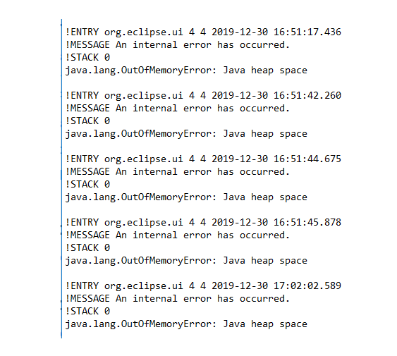

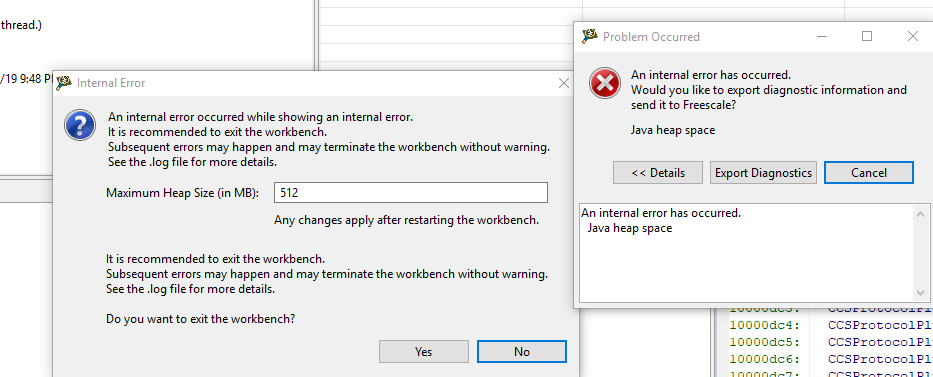

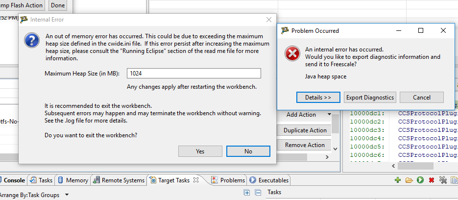

(1) I will send you the log please see attached below, in the log I did notice these below specifically: please also help to answer my second question after this one as well thanks.
!ENTRY org.eclipse.ui 4 4 2020-01-02 15:24:30.284
!MESSAGE An internal error has occurred.
!STACK 0
java.lang.OutOfMemoryError: Java heap space

(2) can you answer me this question please? what is the base address i need to define when I am trying to flash a whole image (contains uboot, device treesm kernel, rootfs)
This is important !
In other words, 1. base address =?
                         2. Apply Address Offset = ?

1. Please create a bareboard project in a new workspace.
2. Please refer to page 3 in document https://community.nxp.com/docs/DOC-332382, the firmware image should be programmed at block 8. In this case, the address offset will be 8*512=4096, which means 0x1000 in hexadecimal.
Yiping

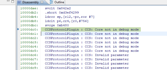

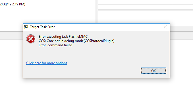

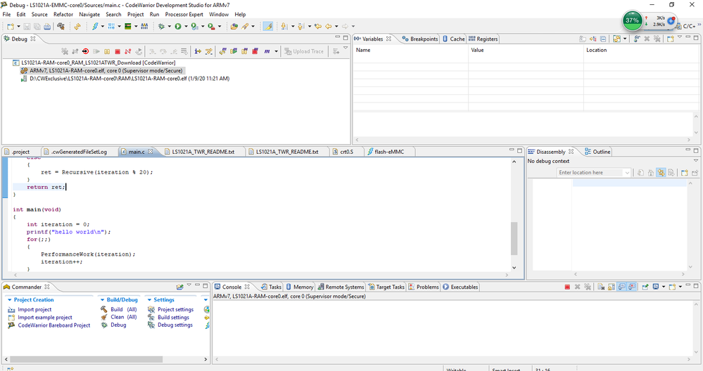

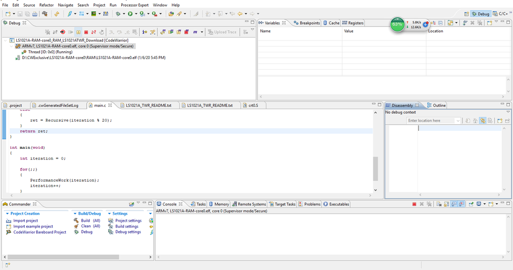

1. I did create new project in a different work space. I am able to get into debug mode
2.I did change the offset into 0x1000
then
It's always starting at 0x10000dc0 says Core not in debug mode. It seems like something try to make the core to quit debug mode.
3. what about the device name?
I have a 8GB eMMC sbut I am testing to flash into a 16 GB Sandisk SD card on eva board right now if that works I will start flash into eMMC
do I need to change anything here ?

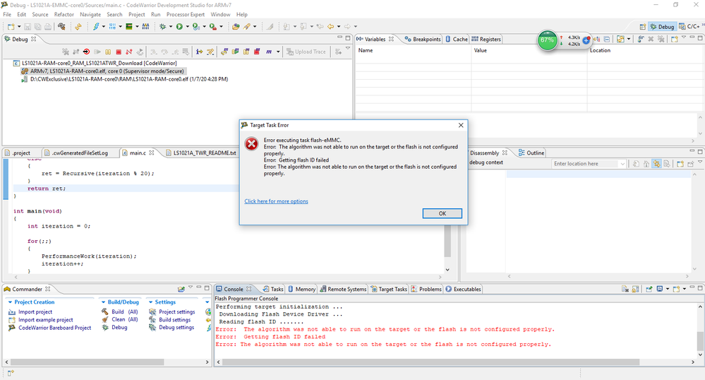

now I am trying to use RAM method to flash the eMMC
Then i do not see any memory mapping on the right window
and this is the log:

    ccs_write_memory; ccs_error = 0; duration=1138 ms
ccs_write_register
    coreh = [serverh:0;cc_index:0;chain_pos:9]
    index = 8703
    count = 1
    size = 4
    value: (size = 4)
         80000130
    ccs_write_register; ccs_error = 0; duration=2 ms
ccs_read_register
    index = 8703
    count = 1
    size = 4
    value: (size = 4)
         80000130
    ccs_read_register; ccs_error = 0; duration=2 ms
ccs_read_memory
    addr = [space:0;size:4;address_hi:0x00000000;address_lo:0x80000100]
    data: (size = 256)
         00889D80 00480440 04B08DC0 08D00000
         003080C0 08300244 08001BC4 DAFF0000
         08301BC0 01308240 08300BC4 F9FF0000
         CA0000C0 16009040 471F8CC0 56340000
         14019CC4 00109044 000051C0 01000000
         20119CC4 00108044 081090C4 0C200000
         000051C4 0000000A 01D080C0 00000000
         0000000A 01AC8240 001090C0 01B00000
         017080C0 D4009644 D4209FC4 00200000
         B50000C0 1B010040 150090C0 CC100000
         563412C0 C4109640 000090C0 01000000
         0130D1C4 00005240 11000008 20000000
         FAFFDCC8 22005240 27005310 03200000
         20208010 01104112 02000CC0 01000000
         0130D100 00005240 05000008 03000000
         FAFFD418 00209040 013051C0 00200000
    ccs_read_memory; ccs_error = 0; duration=14 ms
ccs_write_register
    index = 4103
    count = 1
    size = 4
    value: (size = 4)
         04000004
    ccs_write_register; ccs_error = 0; duration=3 ms
ccs_read_memory
    addr = [space:0;size:4;address_hi:0x00000000;address_lo:0x80000104]
    data: (size = 4)
         00485240
    ccs_read_memory; ccs_error = 0; duration=4 ms
ccs_write_memory
    data: (size = 4)
         700020E1
    ccs_write_memory; ccs_error = 0; duration=6 ms
ccs_read_memory
    data: (size = 4)
         70002040
    ccs_read_memory; ccs_error = 0; duration=5 ms
ccs_write_memory
    data: (size = 4)
         700020E1
    ccs_write_memory; ccs_error = 0; duration=5 ms
ccs_read_memory
    data: (size = 4)
         70002040
ccs_write_memory
    data: (size = 4)
         700020E1
ccs_read_memory
    data: (size = 4)
         70002040
ccs_write_memory
    data: (size = 4)
         700020E1
ccs_read_memory
    data: (size = 4)
         70002040
ccs_write_register
    index = 4160
    count = 1
    size = 4
    value: (size = 4)
         80000104
ccs_write_register
    index = 4176
    count = 1
    size = 4
    value: (size = 4)
         000021E7
ccs_run_core
    ccs_run_core; ccs_error = 0
ccs_read_register
    index = 8703
    count = 1
    size = 4
    value: (size = 4)
         80000130
    ccs_read_register; ccs_error = 0; duration=3 ms
ccs_read_register
    index = 12319
    count = 1
    size = 4
    value: (size = 4)
         000001D3
ccs_read_register
    index = 4130
    count = 1
    size = 4
    value: (size = 4)
         02004012
ccs_read_register
    index = 4130
    count = 1
    size = 4
    value: (size = 4)
         02004012
8,436 Views
yipingwang
Hello Elias Bitbaker,
Please try to use RAM initialization file to initialize the target board. Then in ARM Flash Programmer Task panel, specify the Target RAM address at 0x80000000 to run flash programming algorithm in DDR RAM.
Yiping
8,436 Views
jiye
Contributor V
that is what I did
See this
8,437 Views
yipingwang
Would you please try whether it is possible to run the bareboard "Hello World" sample program in DDR RAM?
Yiping
8,437 Views
jiye
Contributor V
Hi Yiping,
(1)Are you able to provide procedures to do this ?
(2) Also my eMMC size is 8GB what is the right device name from the CW I suppose to use is it stilL SDSG16GB?
8,437 Views
yipingwang
1. Please refer to the section "3.2 Creating and building bareboard project" and "3.3 Debugging bareboard project"  in C:\Freescale\CW4NET_v2017.03_armv7\CW_ARMv7\ARMv7\CW_ARMv7_Getting_Started_Guide.pdf.
2. The algorithm SDSG16GB could be used.
8,437 Views
jiye
Contributor V
Hi Yiping,
I understand all these debugs to perform necessary tasks. However, my situation is I can't even run debug let's say step over in the DDR debug mode (I used the correct RAM init script and mem srcipt)
On the right there is no memory mapping if you see from OCRAM
you are able to see all the memory address mappings
8,435 Views
yipingwang
There is problem with DDR controller configuration in the initialization file.
Do you have LS1021ATWR board? If yes, please try whether you can program SD card on LS1021ATWR with OCRAM launch configuration connecting to the target board.
Yiping
8,435 Views
jiye
Contributor V
it takes me 22 hours to flash a binary from the CW to the SD card via OCRAM. This is definitely not a good practice. Can you give me the right configuration file for DDR?
8,436 Views
yipingwang
For DDR controller configuration, you need to create a QCVS DDR project to generate the initial configuration parameters according to your DDR datasheet or reading from SPD, then use DDRv tool to do validation and optimization.
You could refer to https://community.nxp.com/docs/DOC-333349 .
Yiping
