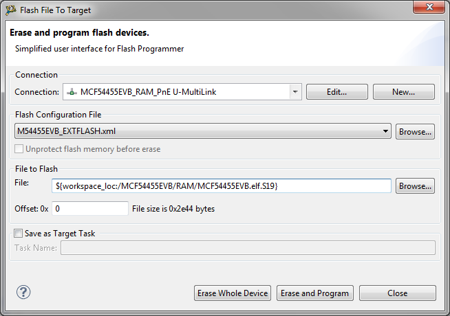

Hi John,
Could you post an screenshot of your flash programmer settings? Here is an example:

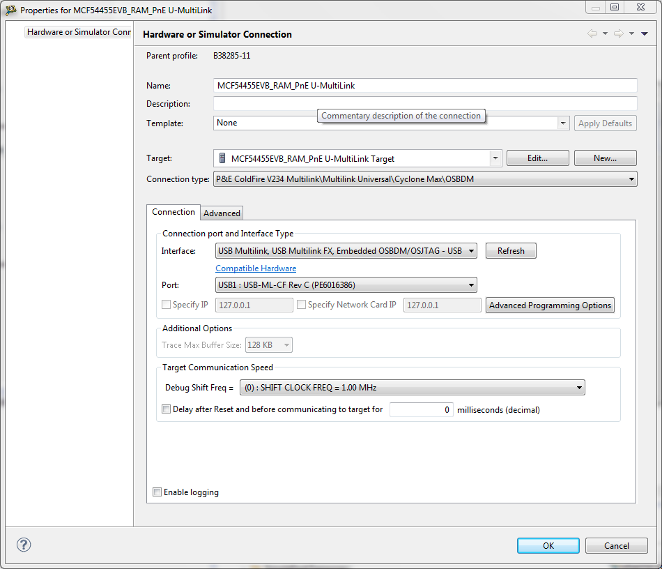

It would also be helpful a screenshot of the Connection settings:

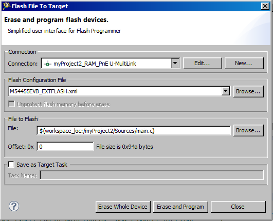

johnmccranie
Thanks for the response. The flash programmer settings are:
and the connection settings:

Carlos_Mendoza
Hi John,
It seems that the error you get while trying to flash your device is happening because the file you are trying to flash is not the correct one, please try changing this file for the one called myProject2.elf or myProject2.elf.S19, these files are generated after you compile the project and can be found inside the RAM folder on you project.
Hope it helps!
