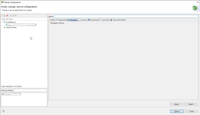

 Hello everyone,
I have installed codewarrior on a new laptop but I cannot debug my code. One strange thing is the "Debugger options" tab in the debug configuration is completely empty. (see the picture below).
2022_09_15_09_37_17_Debug_Configurations.jpg2022_09_15_09_37_17_Debug_Configurations.jpg
Do you have any suggestions on how to solve this problem?

buch2001
I've found out this code, I hope is correct: MC9S12ZMA
S912ZVMAL1F0WLF(R)
LQFP48

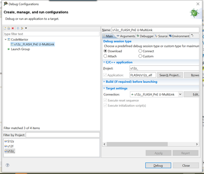

I create a new project from start but didn't see problem. see attached.
Could you please try the same?

buch2001
Thanks for the suggestion, and you're right: creating a new project works fine.
But still it's a problem, because I've inherited this project and I can't create a new project from blank.
There's a way to "convert" it?
Or any other suggestion how to make work the old project?

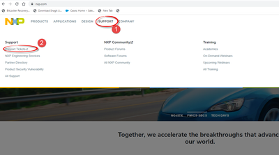

ZhangJennie
Hi @buch2001
Not community private message.
Please submit private case here from nxp site: https://www.nxp.com/
Have a nice day,
