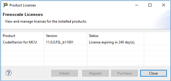

I came across the following issue while trying to debug using Code Warrior MCU V11.0
I have floating license running on my company server. It's reporting correct status:

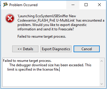

However, if I tried to debug, it would report download size exceeded. My microcontroller is MC9S08GB. The code size is less than 10K.
Could anyone suggest why this happened? Previously with trial license, I was able to debug the project fine. Could it be anything wrong on project setting or license setup?

From your screenshot, your CW recognized your license.
You need contact NXP license team to check your license.
