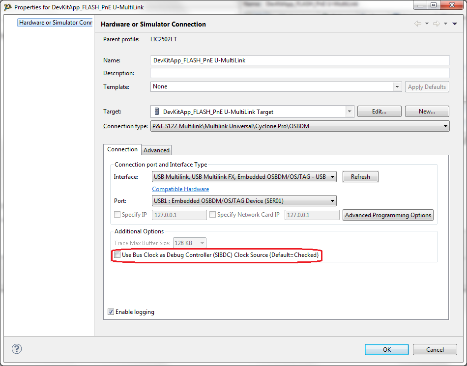

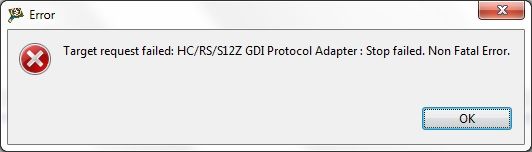

I use CW for MCU to debug program on DevKit-S12ZVC. It worked well until one day I can't debug the program step by step. I got the following information.
And here is the setup.
Actually if I try to debug the sample project, it works fine.
Can anybody help me? Thanks.

6,720 Views
jinliangsun
I fixed this problem by deselecting the bus clock as debugger controller clock source.

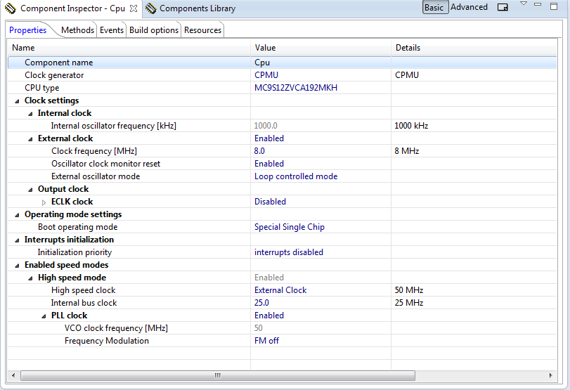

ZhangJennie
From your setting you use 8M external clock. Can you please check if  this external clock function well?
6,720 Views
jinliangsun
Yes I can download my program image to the board and the board works well with my program.
The only issue is that I can't debug step by step to check my program. Now to debug my program I have to add several CAN messages to monitor some variables.
Thanks.
Bruce

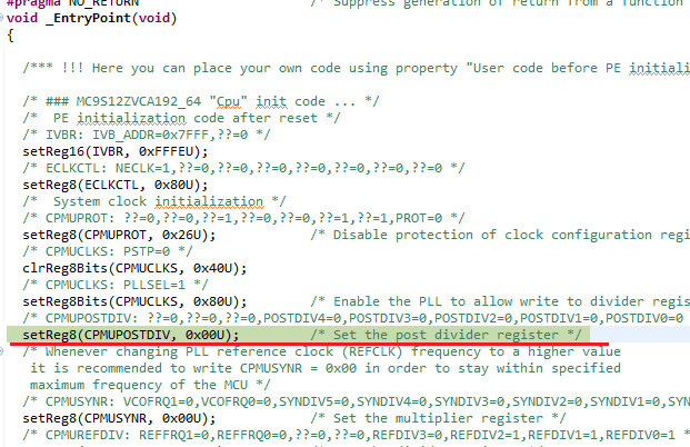

jinliangsun
I changed the debug program execution to Program Entry Point and found the trouble is made by setting Post Divider Register (CPMUPOSTDIV) register.
Is anything wrong with my settings?
