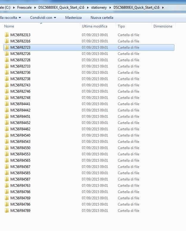

Do you know where can i find the Quickstart stationery example project for MC56F82323 (with all hardware-specific files)?

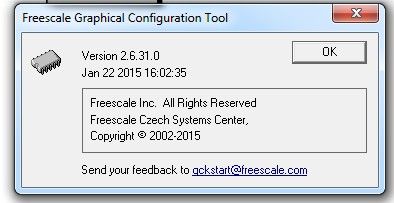

I've installed the latest DSC Quickstart version 2.6.31 but there is no trace of this MCU in the stationery folder, perhaps there is another way for creating  a new project?
i read and unzipped the two files mentioned here DSC56800EX_Quick_Start_r2.6 but i found them not useful for this purpose...

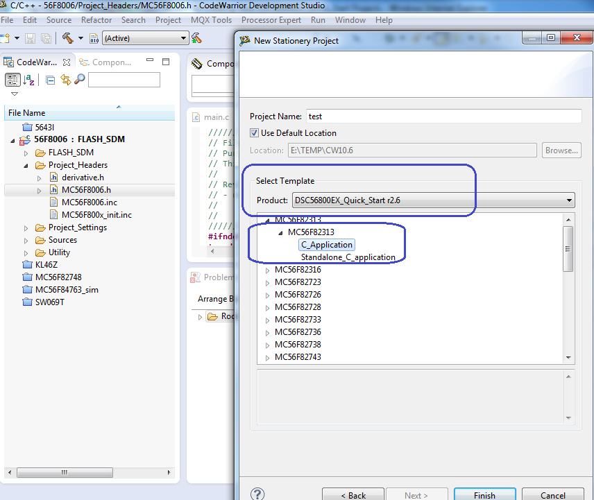

But the menu in CodeWarrior v10.6.x is a little different with CodeWarrior v10.4.  In CodeWarrior v v10.6.x, the step 1) is a little different. To create a new DSC56800EX_Quick_Start project, please go to menu File/New/Other…/Freescale/New Stationery Project

i've already integrated the QuickStart tool in CodeWarrior and i can succesfully see the window you posted.
My question was about creating a new stationery project based on MC56F82323, and i can see in your picture that even your installation (and mine) don't have such a MCU (You have MC56F82 313 and 316, is it correct?).
Now I'm testing this MCU with a project based on MC56F82723 and found no problem but i wonder if there is a way to create a new project based on MC56F82323 via QuickStart tool.
