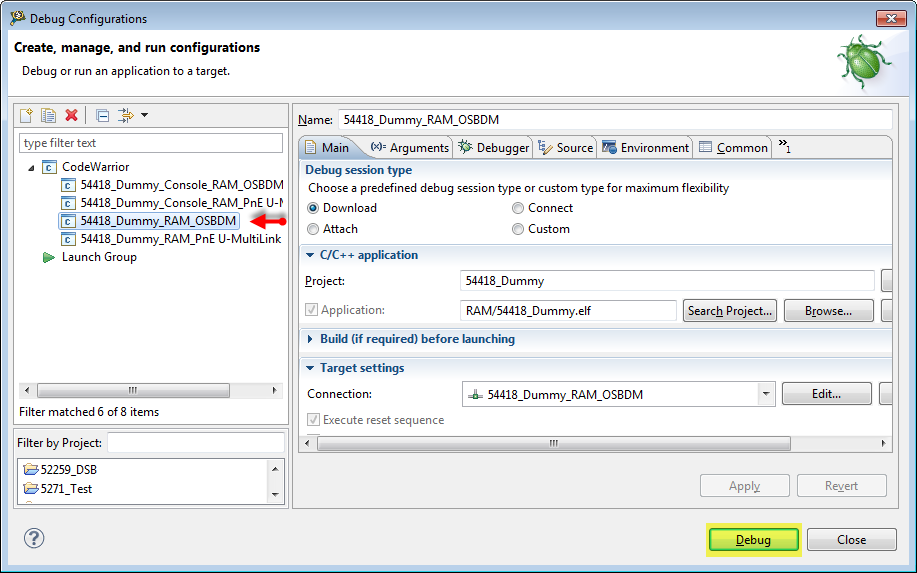

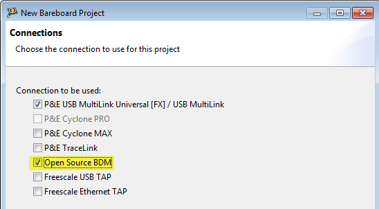

Jorge_Gonzalez
Hello Rob:
In that case it seems you are selecting the wrong connection.
If you use the on-board mini-USB (OSBDM interface) you need to select it when creating a new project.
And then after building your application with no errors go to the tab "Run -> Debug Configurations" and make sure to select the one that corresponds to your connection, in this case OSBDM. Then click on "Debug".

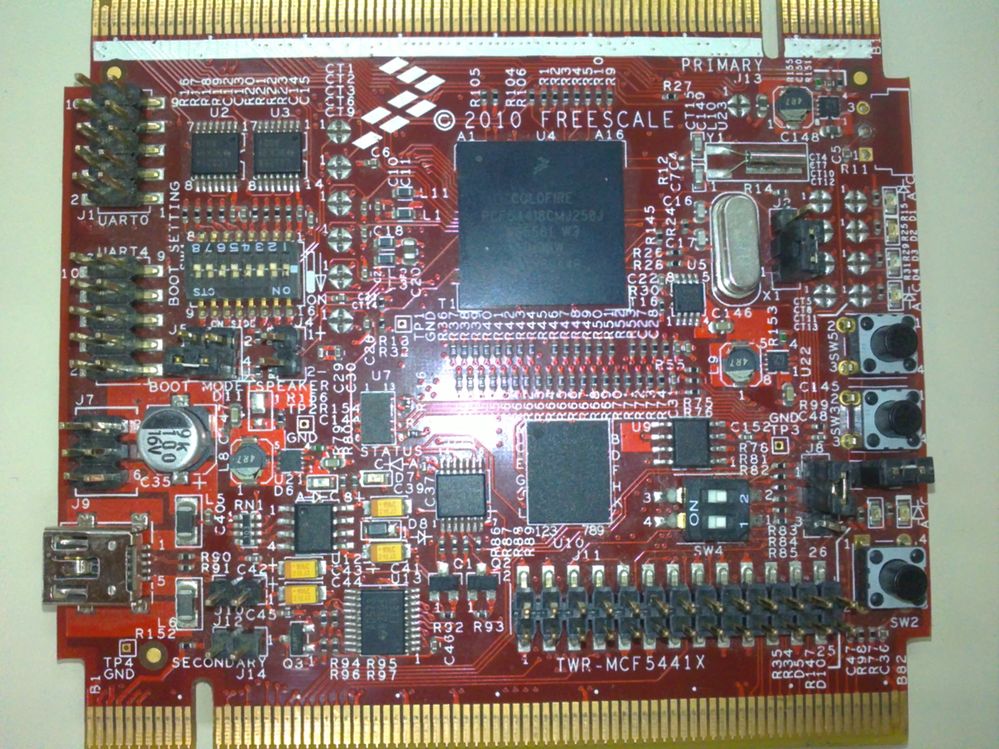

Also, you need to have the proper jumper configuration. You can refer to the default settings from the user manual, downloadable from the next link:
TWR-MCF5441X Product Summary Page
Here I let you an image with the jumper setting you should have:
Please try these steps and let us know how it goes.
Hope this helps!

magicmarmot
Hi Jorge,
I went through and configured the board as per these instructions. Now when I try to run, I get this message in the console
Starting 3rd party flash programming...
ERR: Warning: Programming algorithm not found for this device.
I am set up for the RAM configuration, not Console_RAM, and the debug configuration is set up for RAM OSBDM.
