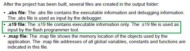

I am using CodeWarrior 11.1. I am trying to connect and debug NTM88 Evaluation board using NTM88 Starter Project. However, when I try to debug no debug configuration can be found. Also, can you tell me how to generate the hex or bin file for this project. So, I can use the flash programmer tool to program the NTM88 Evaluation board.

Hi Markel,
Please take a closer look at the attached UM11325 and follow the steps described in chapter 3.4.1 "Programming a project using the debugger".
To program a project using the flash programmer, please follow the steps described in chapter 3.4.2 "Programming a project using the flash programmer".
Also from the UM11325:
Tomas
