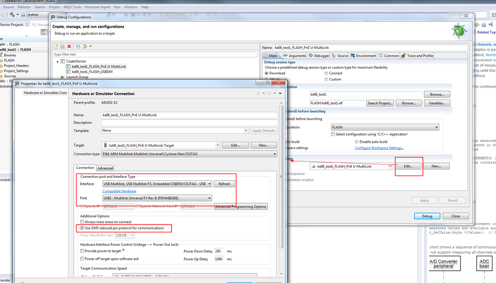

In order to help you solve the problem , please show these screenshot to me when you test on CW10.6 :
-  The debugger configure view
please confirm you use SWD or JTAG interface , if use SWD , please select the option .

Screenshot of debugger config :

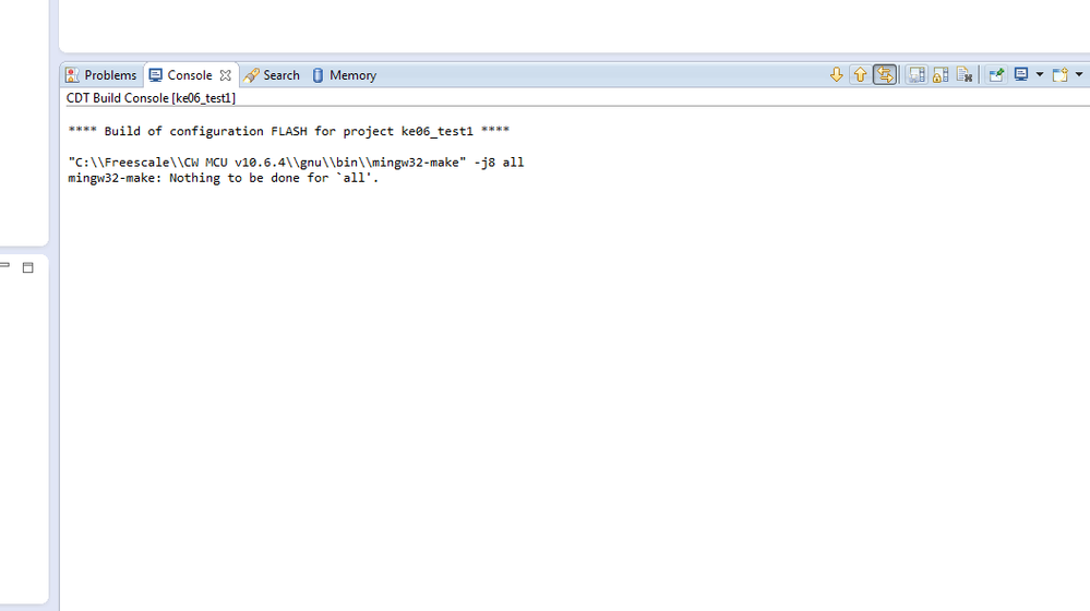

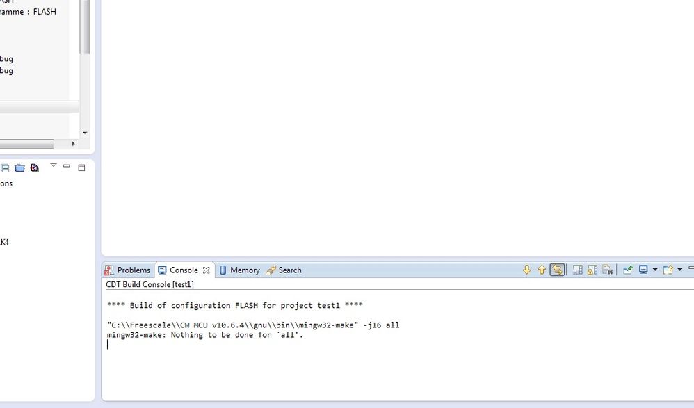

screenshot of builder console
Screenshot of debugger flash programmer error

Hello Johan,
Today , i also use the Multilink Uni FX Rev. A have a test , it can work well .
Please check the hardware  connection , whether reversal, you'd better take a
picture .
