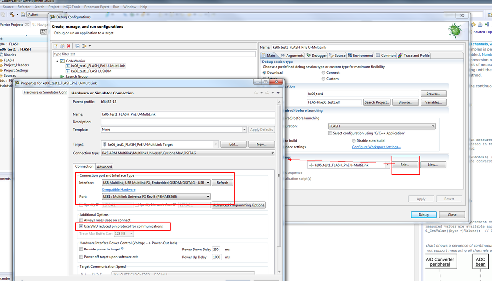

I had to swap my familiar Codewarrior 10.6 environment to Kinetis Design Studio 3 in order to be able to flash a NXP Kinetis MKE04Z128VLD4 by means of Pemicro Multilink Uni FX.  I tried 'freescale_ke04z128m4_pflash.arp' (version 1.03, 06/02/2014 - also used by KDS) as well as 'ke04z128m4_pflash_pipeline.arp' (version 1.02, 02/07/2014), trying to program the target results in a message "CPROGACMP ERROR 15 DURING SCRIPT".
I installed Coderwarrior 10.7 which specific state to support this chip, but the result is the same.
Can anyone make a suggestion how to make it work in Codewarrior.

In order to help you solve the problem , please show these screenshot to me when you test on CW10.6 :
-  The debugger configure view
please confirm you use SWD or JTAG interface , if use SWD , please select the option .
- The error screenshot .

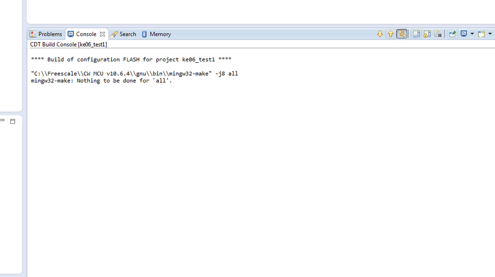

- The console view after debug or show error  :

Thanks for your quick response.
I made some screenshots to show you the response of the Codewarrior debugger.
Screenshot of debugger config :
screenshot of builder console

Hello Johan,
Today , i also use the Multilink Uni FX Rev. A have a test , it can work well .
Please check the hardware  connection , whether reversal, you'd better take a
picture .
