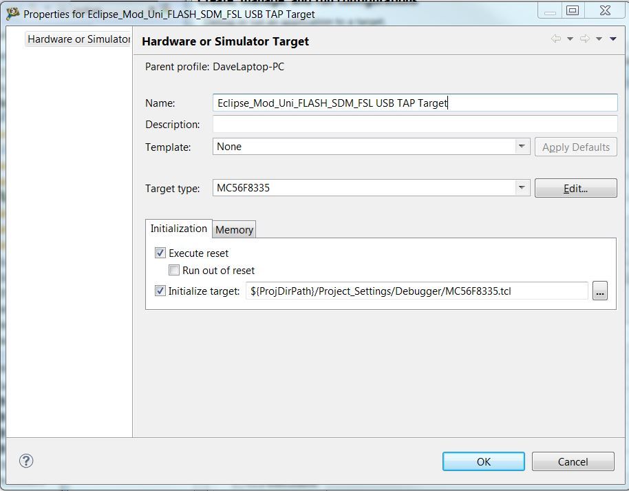

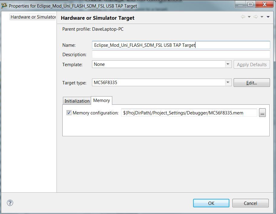

v_dave
Above are two screen shots showing my configuration screens.  I simply change the Target Type to MC56F8345 and it will connect but if I leave the target type at MC56F8335 it will not connect to my target.
Is there a different .mem or .tcl files I need to reference?
3,413 Views
TICS_Fiona
The difference in .mem file is: P flash address is from 0x00000000to 0x00007FFF in “MC56F8335.mem”, while it is from 0x00000000to 0x0000FFFF in MC56F8345.mem.
And the difference in .tcl file is that MC56F8335.tcl does not initialize FMCR, FMPROTB register.
Please only use “MC56F8345.tcl” to replace “MC56F8335.tcl”, and keep “MC56F8335.mem” does it work?
