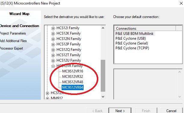

wei_w_he
Dear Jun Zhang,
It really helps and thanks you very much. Just one question: I can see all S12VR serials are added when try to "Create new project" (including S12VR16, S12VR32, S12VR48 and S12VR64),  but when running a project and under " Device and connection", I can only see S12VR64, is this normal? and S12VR64 can be commonly used for S12VR48 and SV12VR32 for debugging connection?
Thanks and best regards
He Wei

ZhangJennie
You said "when running a project and under " Device and connection", I can only see S12VR64 "
Can you please send me a screenshot of it?

wei_w_he
Dear Jun Zhang
I can see all the VR serials during create new project.

ZhangJennie
He Wei
I checked my CW5.2, I don't have this problem.
I also checked CW5.2 can support MC9S12VR48 naturally.
This is CW5.2 device support list:
> - MC9S12C128, MC9S12C32, MC9S12C64, MC9S12C96
> - MC9S12G128, MC9S12G96
> - MC9S12GC128, MC9S12GC16, MC9S12GC32, MC9S12GC64
> - MC9S12GN16, MC9S12GN32
> - MC9S12P32, MC9S12P64, MC9S12P96, MC9S12P128
> - MC9S12XEP100, MC9S12XEP768
> - MC9S12XEQ384, MC9S12XEQ512
> - MC9S12XET256
> - MC9S12XS128, MC9S12XS256, MC9S12XS64
> - MC9S12VR16, MC9S12VR32, MC9S12VR48, MC9S12VR64
Please reinstall CW5.2 or install it on another PC then test again.
