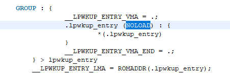

Dear:
when I want to generate Binary File, The error message is as follows:
How can I fix this error?
9 返答(返信)
6,486件の閲覧回数
stanish
The gap is typically caused by having some data from the binary file located in RAM (0x4000_0000) whereas the rest of the application is placed into FLASH (0x0000_0000).
I'd guess in your case ".exec_vect_vle" section is loacted in RAM right? is it some code running from RAM?
There was very  similar question related to GCC compiler:
https://community.nxp.com/message/1102293?commentID=1102293#comment-1102293
Hope it helps.
Stan
6,486件の閲覧回数
maoyuanluo
Hi:
   when i use the NOLOAD keyword in *.lcf file in CodeWarrior 10.6.4 IDE, it show me the error:
   and I found the IDE have no NOLOAD keyword in help contents:
I don't know how to solves it, please help me to fix it. Thank you!

Hi Zhang,
   Chip type is MPC5606B
Thank you!
6,486件の閲覧回数
danielchen
Hi Maoyuan:
I would suggest you check your linker file.    especially  .bss and .exec_vect_vle.   check the address is valid ?
From your log, it seems the gap wasn't updated correctly (too much).
6,486件の閲覧回数
maoyuanluo
use same lcf file, i can generate mot file, but i can't generate bin file.
I don't know the difference where it is.
