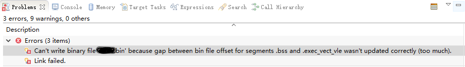

Dear:
when I want to generate Binary File, The error message is as follows:
How can I fix this error?
9 Replies
6,228 Views
stanish
The gap is typically caused by having some data from the binary file located in RAM (0x4000_0000) whereas the rest of the application is placed into FLASH (0x0000_0000).
I'd guess in your case ".exec_vect_vle" section is loacted in RAM right? is it some code running from RAM?

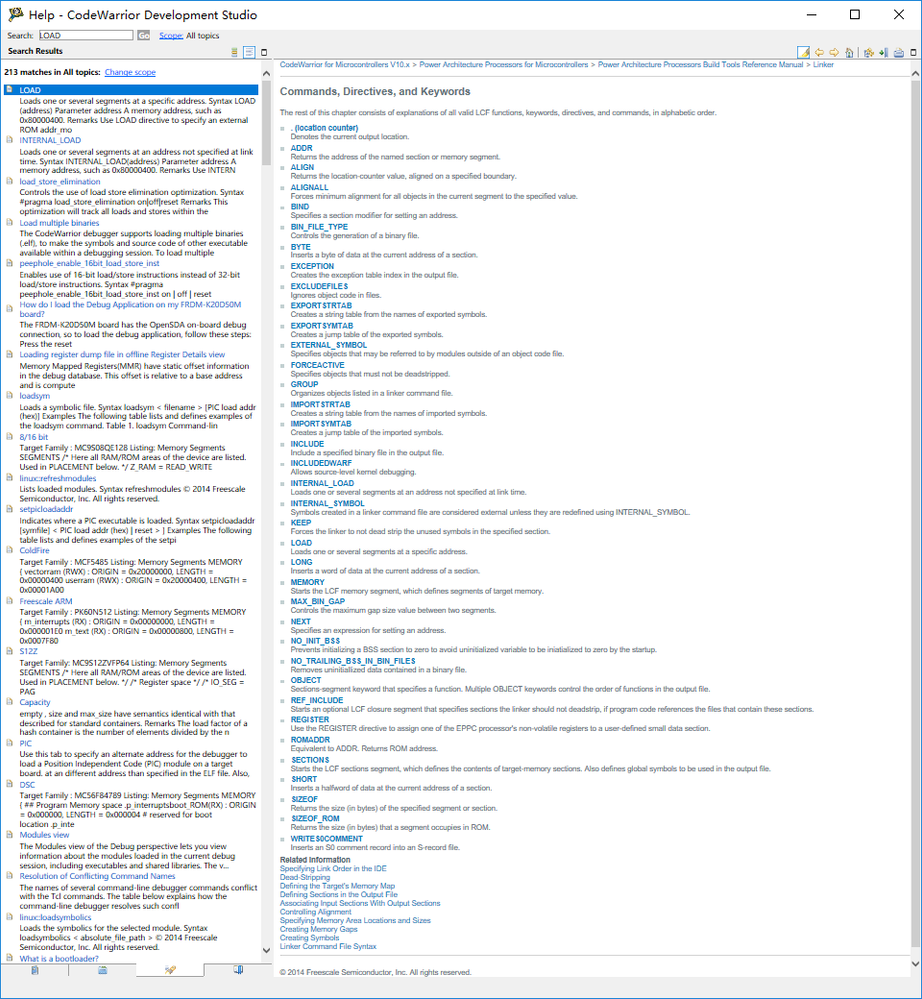

maoyuanluo
Hi:
   when i use the NOLOAD keyword in *.lcf file in CodeWarrior 10.6.4 IDE, it show me the error:
   and I found the IDE have no NOLOAD keyword in help contents:
I don't know how to solves it, please help me to fix it. Thank you!

danielchen
Hi Maoyuan:
I would suggest you check your linker file.    especially  .bss and .exec_vect_vle.   check the address is valid ?
From your log, it seems the gap wasn't updated correctly (too much).
