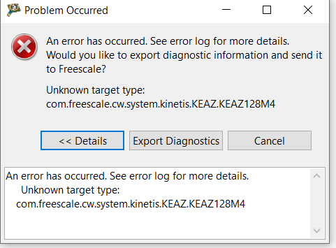

I just finished instaling codewarrior and tried adding a demo but i got this error: pastedImage_1.png
Is there any aditional software or plugins that i need too install?

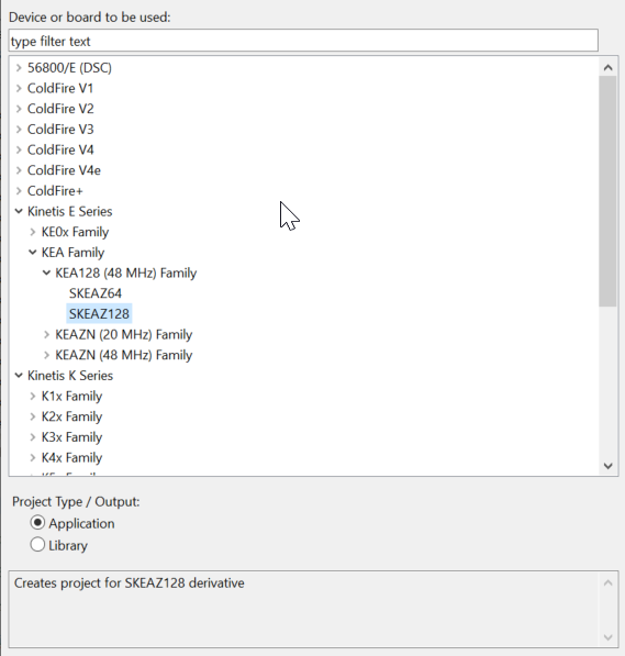

Also i tried creating a new Bareboard Project, but cant fiind the micro i am using in that list.
The micro i use is a S9KEAZ128AMLK.

Well i had some plugins missing and didn't see the micro in the list, but after I installed them it works.
Thank you anyway.

Alexis_A
Hi [email protected]‌,
To create a new project using the KEA select the bare board option selecting File Tab ->New->Bareboard project
For the KEA family, these are under the Kinetis E series:
I hope this helps you.
