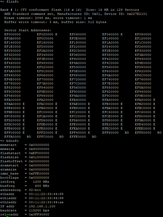

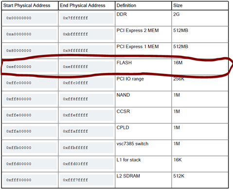

Now, my problem here is with the flash mapping. NXP documentation shows the flash memory mapped to addresses between 0xEF000000 to 0xEFFFFFFF (16 mb) as:
U-Boot executing on the target, provides the same information (please notice flashstart and size):

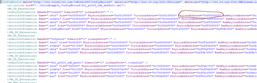

On the other hand, NXP Codewarrior template for the target, as well as WindRiver BSP files, point to a different Flash memory mapping: from 0xFF000000 to 0xFFFFFFFF - and hence the same 16mb, but shifted.
VxWorks mapping:

I am able to flash VxWorks image using CodeWarrior to these addresses (as you can see above, the memory is "programmed" in the good addresses), but I am not able to execute it, because there is no boot-loader. When I try to reach for this area with U-boot, to copy to memory and initialize, obviously it does not see the area.
If I try to adjust the flash memory map on CodeWarrior, to comply with the documentation (starting at 0xEF000000), CodeWarrior returns an error message that the target flash does not exist / is not available.
So, I am in a trick situation. I can flash the image and verify it was flashed with codewarrior, but at the same time I have conflicting information with U-boot. The funny part is that Linux images that came with the board were overwritten, but not U-boot. BUT, linux images were also in the 0xEF range, which I supposedly never touched.
Am I missing something here?
Thanks in advance for the assistance!
2,627 Views
yipingwang
In PowerPC Architecture, memory map is configured by LAW(local access windows), you could refer to "2.4 Local access window registers" in P2020 Reference manual.
In CodeWarrior initialization file
Freescale\CW_PA_v10.5.1\PA\PA_Support\Initialization_Files\QorIQ_P2\P10xx-P20xxRDB_P2020_init_core.tcl, local bus NOR flash is configured as the following, 0xFF000000 - 0xFFFFFFFF LAW0 is configured for Local Bus NOR FLASH.
# configure local access windows
# LAWBAR0 - Local Bus
# bit 8 - 31 = 0xFF000000 - base addr
mem [CCSR 0xC08] = 0x000ff000
# LAWAR0
# bit 0 = 1 - enable window
# bit 7-11 = 00100 - Local Bus
# bit 26 - 31 = 011011 16M - size
mem [CCSR 0xC10] = 0x80400017
In u-boot, in board/freescale/p1_p2_rdb_pc/law.c, NOR flash is configured as the following.
SET_LAW(CONFIG_SYS_FLASH_BASE_PHYS, LAW_SIZE_64M, LAW_TRGT_IF_LBC),
In include/configs/p1_p2_rdb_pc.h, the macro is definition as the following.
#define CONFIG_SYS_FLASH_BASE_PHYS      CONFIG_SYS_FLASH_BASE
#define CONFIG_SYS_FLASH_BASE           0xef000000
So the memory map in CodeWarrior is different from u-boot.
