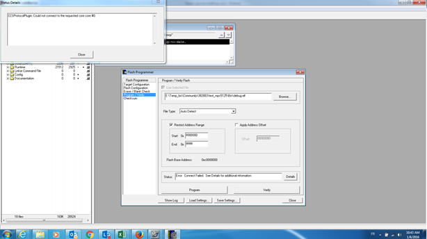

I had just installed CodeWarrior DS for MobileGT Processors, Flash Programmer (Windows Hosted) WIN with Node-locked License.
Had connect the USB dongle and codewarrior TAP (without any target board) and tried out the software, under "tools - Flash programmer - Erase/Blank check - checked All Sectors". Once i check on Erase, there's a message saying "CodeWarrior Flash Programmer requires a license..."
Do i have to install a license for flash programmer? If yes, where can I download from?
Else how do i solve this problem?
Thank you.

I had follow the steps in the pdf file but still having the same issue. “status detail “CW Flash programmer requires a license….”
· Firstly, I installed CW MGT V9.2 win7 from the dongle.
· Next, rename the old ccs file to ccs_old and add the new ccs file (given by Fiona) in the folder.
· Then, follow the 7steps written in the readme.txt (ccs-drivers-usb-readme.txt)
I could not navigate “\ccs\drivers\usb\jungo\” using command prompt (administrator), therefore I proceed to c:\.....\ccs\drivers\usb\jungo\detect. Run detect, message shown “Jungo USB driver NOT found for CW USB TAP or USB HTI.” · Next, same thing couldn’t navigate “\ccs\drivers\usb” using command prompt (administrator). Proceed to c:\....\ccs\drivers\usb and run setup. Drivers successfully installed.
· Plug in CW with Ethernet cable. Launch CW MGT V9.2.
For flash programmer,
Tools- flash programmer- target configuration\load setting\choose “Lite5200_16MB_flash”
- Flash configuration\choose device: S29GL128P\ choose Organization: 16Mx8x1
- Erase blank check\tick all sectors\click Erase
Status: Error: Connect Failed
Details: “CW Flash programmer requires a license….”
For Hardware Diagnostics,
Tools- hardware diagnostics- configuration\ select processor family: 52xx \ select target processor: 5200\ choose connection: CW Ethernet TAP\ click Load setting\ would like to choose 0_HWDDefaultConfig_MPC5200B.xml but not found. There’s only HWDDefaultConfig.xml inside the hardware diagnostics-EPPC folder.
If were to choose HWDDefaultConfig.xml, error message “Target initialization file does not exist” “Generic processor is not available; setting processor to first in list.”
Do I have to do any network connection between the codewarrior tap and my laptop? Currently I’m trying with Ethernet cable.

Regarding the license file, it seems there is a problem with the license file used.
Associated to your CWP-BASIC-NL_1-xxxxxxxx registration I see you've downloaded several license files:
    - CW for MGT V9.2 - Flash Programmer (Windows Hosted),
    - CodeWarrior DS for Power Architecture V8.8, Flash Programmer Edition (Windows Hosted),
    - CodeWarrior for Power Architecture V10.5  - Basic Edition (Eclipse-Windows Hosted).
Is there a problem with MGT license file ?
    It's possible and I will check it on my side.
For basic suite license file , MGTV9.2 and PA V8.8 are using the same license file.
I'm sure the CodeWarrior DS for Power Architecture V8.8, Flash Programmer Edition (Windows Hosted) license file can be used on MGT v9.2.
Can you try this license file ?

Before to try to use the CodeWarrior TAP we must be sure the license file is running which is not the case at this time.
I've perfromed some tests on my side and found there is a problem with the license file for MGT V9.2 Basic Suite.
This license file is not working - I've contacted the license team.
However the license file for  CodeWarrior DS for Power Architecture, Flash Programmer Edition (Windows Hosted) WIN V8.8
is working for MGT too.
This is working on my side.
To avoid problem I recommend you to remove, rename all license files you've on your local disk and valid the PA V8.8 Flash programmer license file only.
Now you can launch the Flash Programmer Tool without problem.
Is it working now ?

evanlim
Hi Pascal,
I’m still having problem.
I had uninstall and reinstall GT V9.2 again. Tried with PA V8.8 license, encounter same problem.

Evan,
Please, provide me the license file you're using.
You're using Windows version isn't it ?
Pascal
NXP Technical Support
60,098件の閲覧回数
evanlim
Hi Pascal,
Yes window version. My laptop is window 7, 64-bit.
Had attached the license file in this email.
Thank You.
Evan
60,098件の閲覧回数
trytohelp
Evan,
May be there is a problem with the license file generated.
Does the volc C: disk ID is DISK_SERIAL_NUM=00156389 ?
Pascal
60,098件の閲覧回数
evanlim
Hi Pascal,
Volume in drive C is Window7_OS
Volume Serial Number is 0015-6389
If the problem is the license file, is it possible to generate a new license file for me?
Thank you.
Evan
60,098件の閲覧回数
trytohelp
Evan,
Your license file is working fine.
I've change the DiskID of my PC and used your license file.
On my side the license file is working fine.
I can use the Flash Programmer without problem (I mean license issue).
Attached the license file I used.
Pascal
