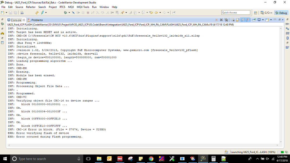

I'm using code warrior development studio – v10.6 and MC9S12ZVL32 microcontroller.
I’m facing a problem while debugging. The code warrior studio hangs at flashing stage and doesn’t come out of it. Build project is successful, but flashing via debug configurations is hanging. If flashed via Flash Programmer, flashing is successful but the software doesn’t run.
Also CRC-16 verify error is observed while downloading via debugger as shown in screenshot.

Hi Kiran,
Does this problem rely on a specific project or a common issue for all project?
if the problem is only with a specific project, can you send me the project thus I can test it from my side?

This problem is specific to project. Unfortunately i cannot share the project as it is confidential.
However i have exported the programming failure log. But i was not able to attach the same here.
Do let me know alternative ways of sending this log to you.

Hi Kiran
If your project is not ok to visible to public, I suggest you create a private case to NXP technical support team.
https://community.nxp.com/docs/DOC-329745
We don't want your entire working project. please just create a demo project that we can reproduce your issue.
