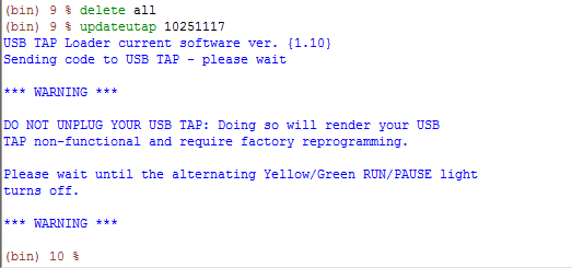

xiangjun_rong
Hi, Emily,
Pls try to set the USBTAP in CCS, pls run the instruction:
delete all
update utap xxxxxxx
The xxxxxx is the unmber index on the back of USBTAP device, for example, my USBTAP number is 07350003
Hope it can fix your issue.
Xiangjun Rong
8,379 Views
emilycheng
hi xiangjun:
    I have tried this as below:
     after these, the tx/rx led is always red and the run/pause led turn off after flashing yellow/red.
using the programer tool to download , the error still exist.

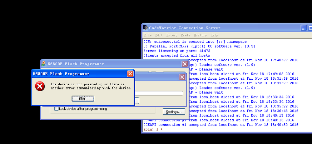

emilycheng
hi brian:
    1. connect the usb tap to the target board and to pc:
         the TXRX led blink in red;
     2.Applied power to the board:
     3. After clicking the Program,
         the TXRX led blink in yellow or green and the run/pause is red.and at the same time
report error message as below:
8,379 Views

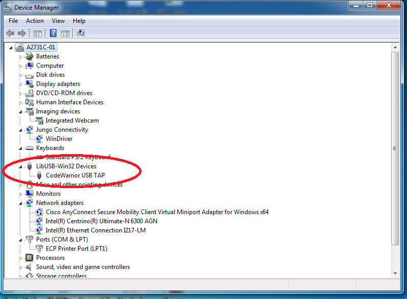

After you connect the USBtap, can the PC recongnize the USBTAP?
This is the screenshot on my PC after I connect the USBTAP device?
If you can not, the USBTAP may break down or the USBTAP driver has issue. In the case, pls try to install the USB driver ans see the ccs_drivers_installation_help.txt located at:
C:\Program Files (x86)\Freescale\CodeWarrior for DSC56800E v8.3\ccs\drivers

emilycheng
Hi xiangjun:
    YES, please refer to the screen snap which i have send to you in above history:

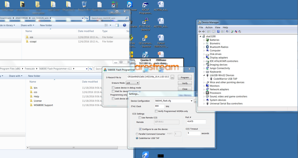

xiangjun_rong
Hi, Emily,
Regarding your question, firstly, do you use Win7 OS, if you use it, you have to download an4338SW, and unzip it.
Then replace the CCS directory of the Flash programmer tools with the unzipped CCS directory of an4338SW.
If you do not use Win7, it is another story.
Firstly, do you use EVM board or your own target board, if you use EVM board, because there is on-board parallel port, there is a jumper called "CC DIS", you have to close the jumper.
Secondly, you should download xxx.elf.s which is generated by CW for DSP56800E tools based on your application, this is the S recorder file.
Thirdly, pls use correct configuration file which is loacted at:C:\Program Files (x86)\Freescale\CodeWarrior for DSC56800E v8.3\M56800E Support\initialization
Hope it can help you
Xiangjun Rong
8,379 Views
emilycheng
Hi Xiangjun:
    Thanks for your support, i have do as you said as below:
the DSP we use is MC56F8335vfge,not sure if it's right to choose 568345_flash.cfg .
and the error message is still exist as below:
error log as below:
could you help , thanks.
