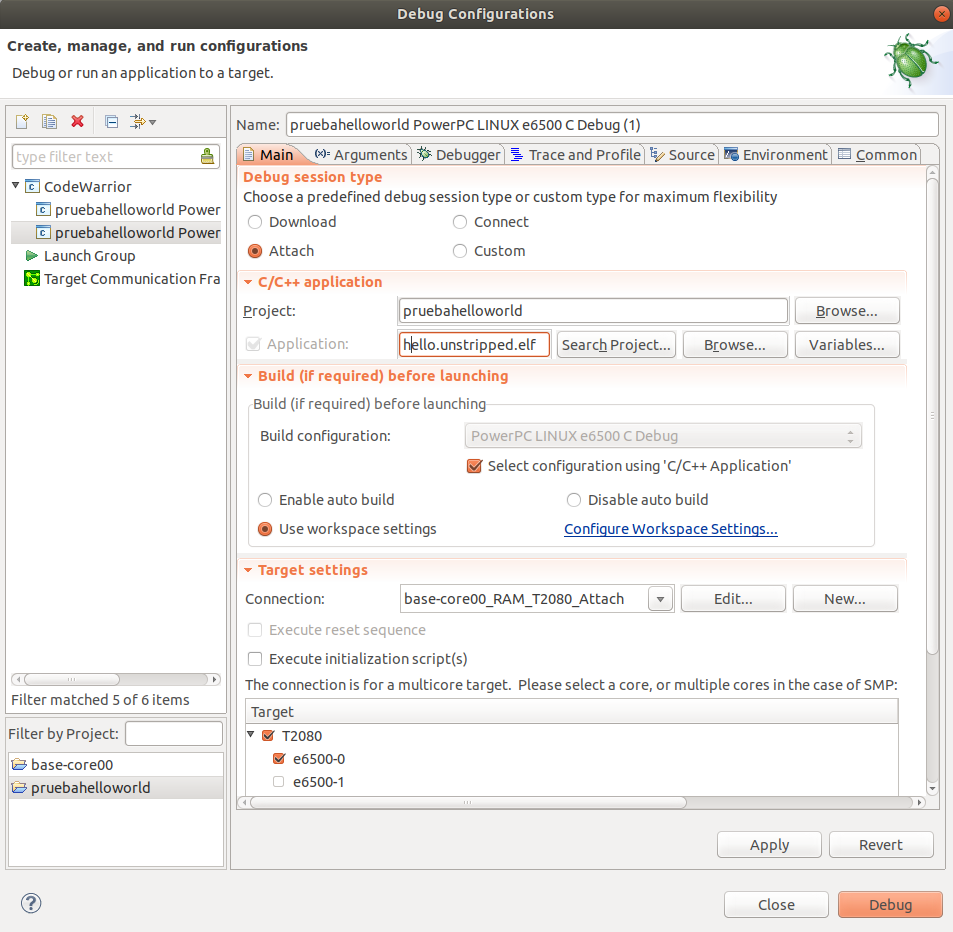

We create a codewarrior bareboard project(QoIQ_T2 family and T2080 processor), using board T2080RDB-PCIe with attach launch and the connection type codeWarrior TAP(over Ethernet)· The next screenshot shows the debug configuration:

For T2080 processor, please download and install CodeWarrior for PA 10.5.1.
The Attach launch configuration is often used to debug program boot from NOR flash, for example debugging u-boot.
If you want to download the program to RAM then perform debugging, you need to use "Download" Launch configuration. You could import the elf to create a project and select "Download" launch configuration.

I would like to thank you for your fast answer. As we comment, our use case is not downloading a bare application to the RAM, as we are using a RTOS whose image is composed by a kernel, several applications and a ROM filesystem.
For this reason, our use case is more similar to the case that you describe about debugging a boot program from NOR flash (for example u-boot as you said). We cannot download the application directly in memory because it would mean that the rest of the system is not downloaded to the board and the execution would be impossible.
We have developed in the previous answer all the configuration of the project in CodeWarrior to make clear what is the configuration that we are using, and we have explained the addresses used in our application only to show the  discordance between the actual content of the application and the content showed in the memory monitor of CodeWarrior.
We understand that when we suspend all the cores of the processor and they are using the MMU, when we select a range of addresses in the memory monitor and we select the Virtual Space the content showed in the memory monitor should be correct in the virtual space of the current thread (independently of running in Hypervisor, Supervisor or in user space), but this is not what we are seeing.
I suppose that this use case is very common as a processor so powerful like the T2080 is usually used with RTOS and not only with bare metal applications, but with the information that you provided in your previous answer we still don't know how to proceed with this use case. Do you know if it is possible to use CodeWarrior in such type of environments?, or do I have to derive from your previous answer that CodeWarrior only can be used for bare metal applications?
