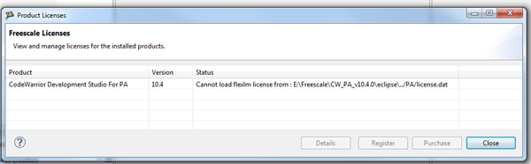

I was able to get the Flex License server to see the license.dat (security permissions)
BUT when i run cwide.exe and go to Help>Active License = its not showing any licnese
i have added the DAT to the flexserver folder and also the freescale PA folder.
1,965 Views
trytohelp
Hi Todd,
In case of floating license file, the right information is provided by the log file generated on server side.
Why ?
if the license file is used in client and on server, the server will use all features included in the license file.
However for the client, it's another story as it will see the first lines only up to the USE_SERVER keyword.
The right way to check a floating license is to refer to the log file.
Specific trouble for CW for PA V10.4 & CW for MCU V10.6
Under PA V10.4 for instance when the port@host environment variable is used and the service is running on server, when we launch Eclipse we get a wrong license information:
According to the message the license file is not found.
For MCU V10.6, the Help + Freescale Licenses menu is not available.
PA v10.4 and MCU V10.6 using port@host protocol gives you the same message than if no license file was used/defined.
It seems the Product is not detect when the LM_LICENSE_FILE Environment variable is using port@host.
