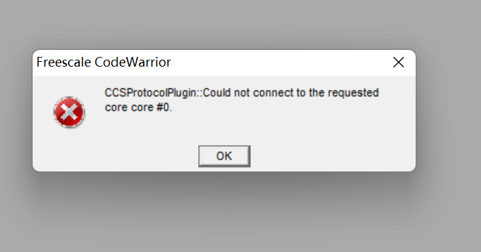

My OS is Windows 11(64bit), Development Enviorment is CodeWarrior(PA8.8.5), and the emulator is Codewarrior TAP.
I set the debugger as the Readme file in the example projects of the CodeWarrior, however, when I want to debug the project, it just report the error:

Please apply Patch 8.8.6 to update CCS USB driver to support CodeWarrior TAP.
