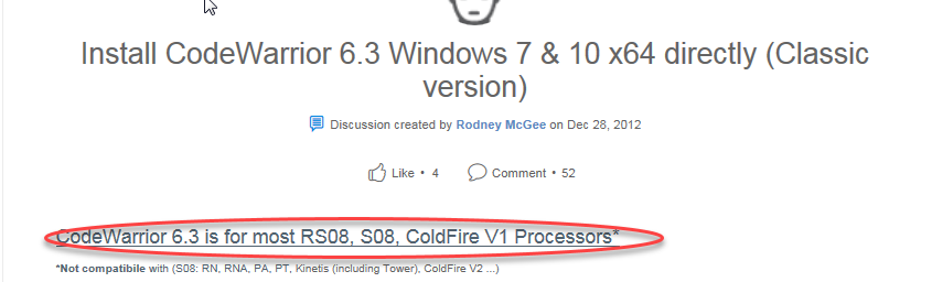

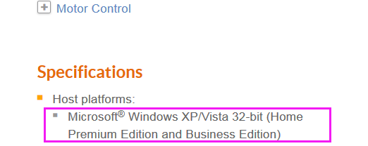

Hello Sarang,
It doesn't support the Win7,
CodeWarrior for Microcontrollers-Classic IDE|NXP
There is a DOC about how to install it on Win7,you can have a try.
https://community.nxp.com/message/310577
Hope it helps

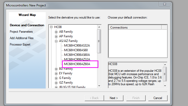

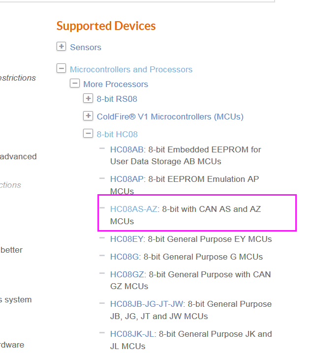

Hello Sarang,
The CodeWarrior 6.3 is the CW IDE version 5.9 just like you said.
And yes, it support this chip : MC68HC908AZ60.
You can see this in the linker i mentioned :
Also i check the IDE :
