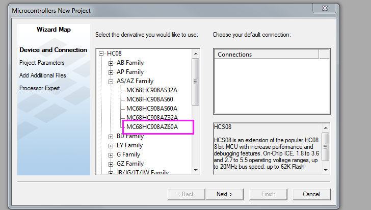

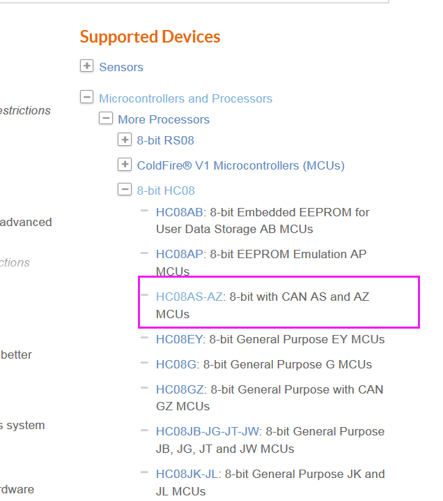

I am not yet sure whether IDE 6.3 supports HC08 processor like (MC68HC908AZ60) bcos it is not mentioned clearly in link you provided. Can you see it in Microcontroller list of IDE? please let me know....
4,453件の閲覧回数
Hello Sarang,
The CodeWarrior 6.3 is the CW IDE version 5.9 just like you said.
And yes, it support this chip : MC68HC908AZ60.
You can see this in the linker i mentioned :
Also i check the IDE :
Alice Yang
