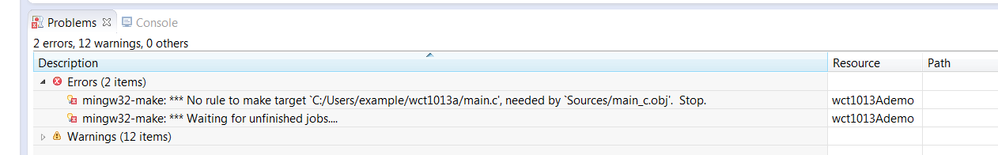

Hello everyone,
I just installed CodeWarrior 11.0 and downloaded WCT_MPTXAUTO_V3.1 eval code, when I build the project, got this error mesasge shows in picture below. Did anyone have the same issue? Can someone help me to get the setup working?
Thanks a lot,
Martin

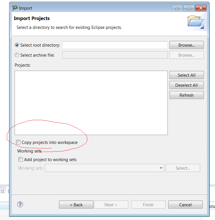

Here is the fix :
When import the projects, there is an option “Copy projects into workspace”, when uncheck this option, issue resolved.
