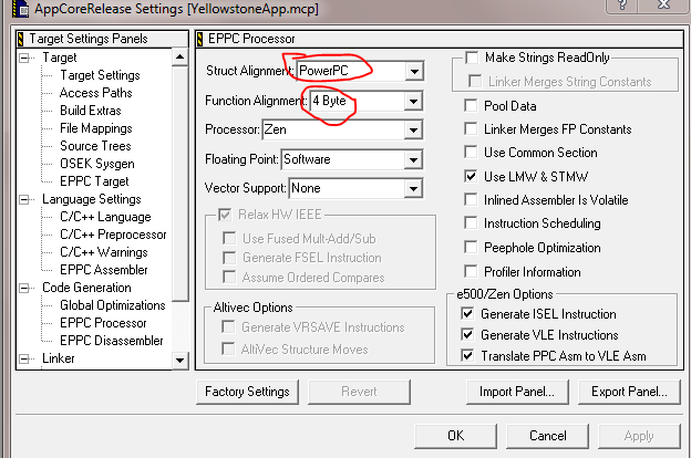

lvyang
IDE:5.9.0
How to understand the content with red color.
struct Aligment: PowerPC   1 Byte aligment?
Function Aligment: ?

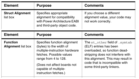

here is some simple description:
If you want to know more about alignment, please look at the document in the attachment.

martin_kovar

lvyang
Thanks very much, I want to konw more about the aligment but i can't find the attachment.Could you send it to me again, thanks.
4,302 Views
martin_kovar
please look directly at the following URL. There is the attachment below my post.
https://community.nxp.com/thread/437644
Martin
