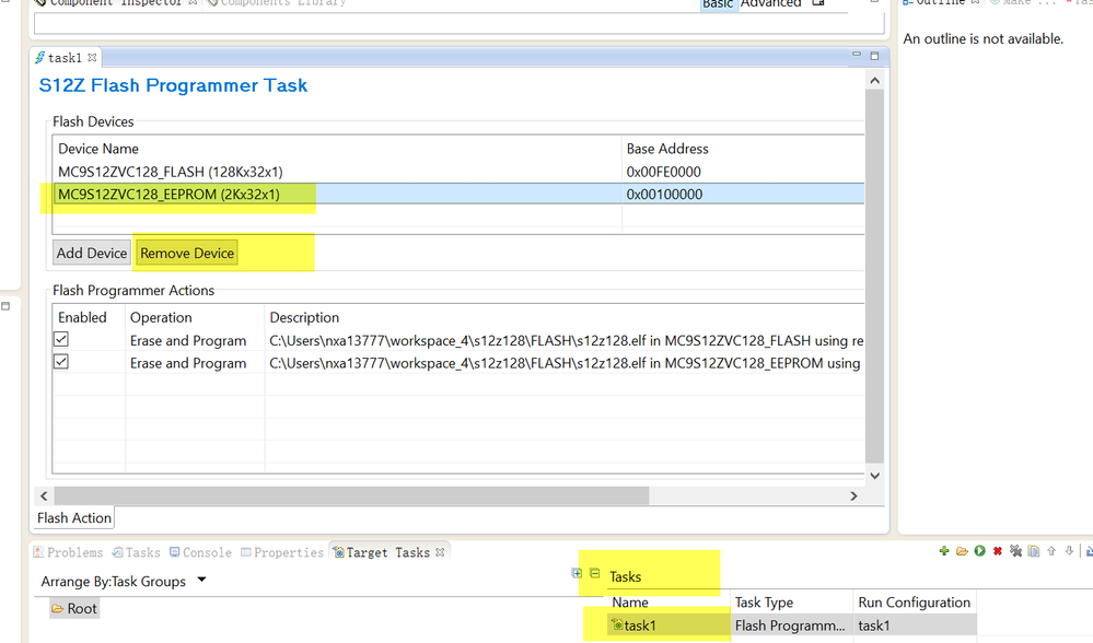

Build the example:AN5327 in CW10.7,the EVB is s12zvml12EVBLin. When I debug it, everything is ok. But when i flash the file to target, there is a warning:Can't program 8 bytes to address 0xfffff8 because this range isn't included in the selected modules!  Device MC9S12ZVML128_EEPROM.

The address 0xFF_FFF8 belongs to Program NVM segment and it can be programmed by the  Flash algorithm
MC9S12ZVML128_FLASH , The warning indicates that the data at this addresses cannot be programmed by the selected algorithm ( MC9S12ZVML128_EEPROM) and ignores the appropriate s19 line. To get rid of the warning please make sure your S19 file contains just data accepted by the selected flash algorithm.

        In the CW10.7, I use flash file to target, but the MC9S12ZVML128.xml is the only  flash config file I can choose, I wonder how to fix this warning.  If a config file is needed, where can I find this document.

Hello Amos,
Please save your "flash file  to target" task:pastedImage_1.png
then you can find the task1 in "Target Tasks" view, double click the task1, you can find the flash config file in it,
please refer to your requirement configure it :

         Thank you for your particular reply and patience! There is no any warning now, and I have downloaded the .s19 successfully.
