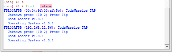

Still can't connect to CCS.
I updated the probe OS. findcc now recognizes the probe tip, though it does call it a Cortex-10 tip.

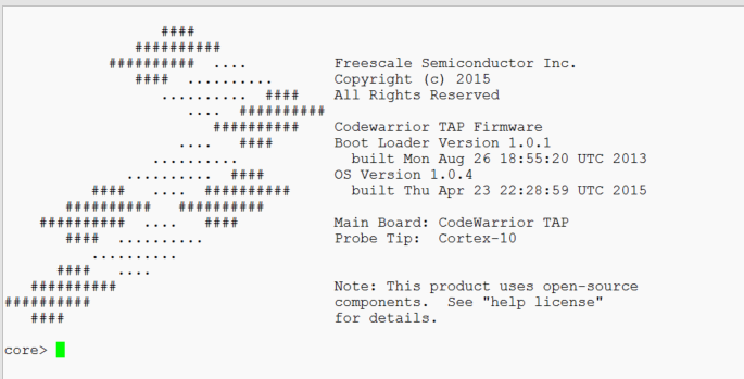

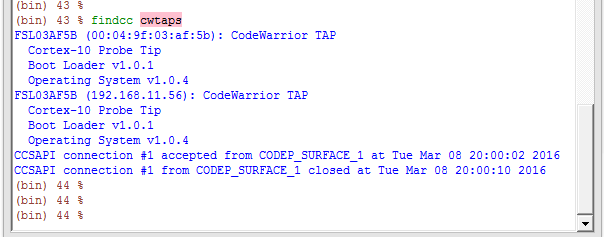

Here's some evidence that the TAP probe is attached and alive:

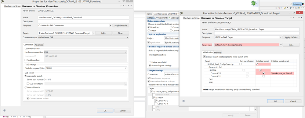

jasonhendrix
Contributor V
I figured out how to add an initialization script for the Initialization and Memory tabs (click in the table cell in the right-most column in the "core" row. see attached picture).  No change in the ccs connection problem, however.

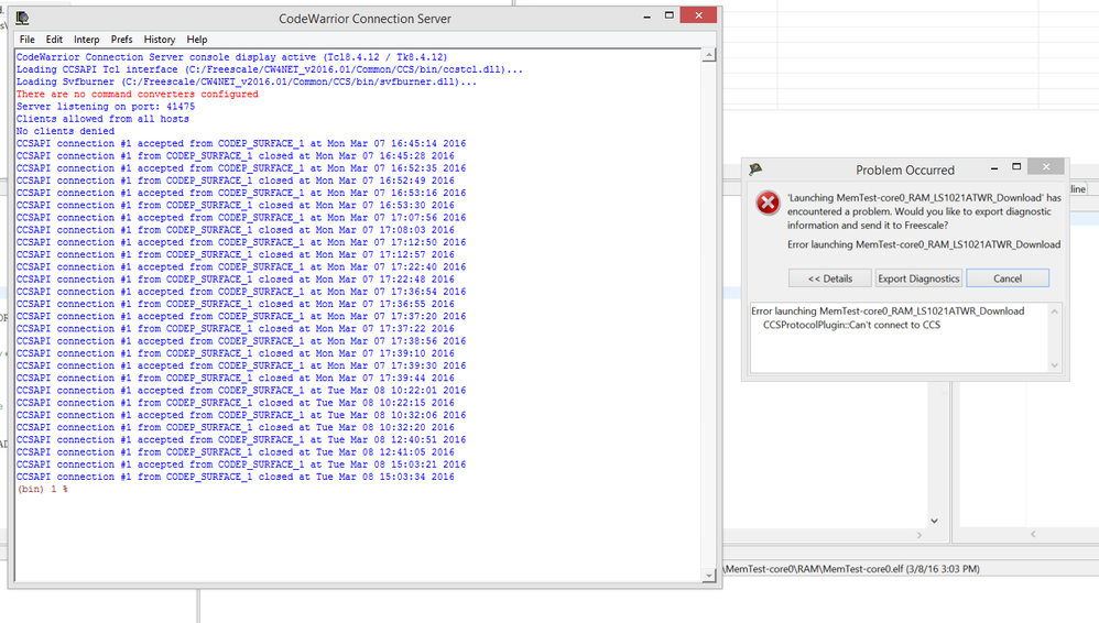

jasonhendrix
Contributor V
Still getting the error "Can't connect to CCS Server".  But I did find the CCS console and it claims the connection was opened momentarily and then closed.  I'll try attaching a picture:

jasonhendrix
Contributor V
Thanks for the response.  Unfortunately, I can't perform step  7, because:
"/LS102xA_Rev1_ConfigChain.cfg/LS1021A/C...Initialize target script is undefined."
That's the message that appears at the top of the "Hardware or Simulator Target" window as soon as I select the "Initialize Target" checkbox in the Initialization tab or the "Memory Configuration" checkbox in the Memory tab.
12,358 Views
jasonhendrix
Contributor V
See post below for solution to the "script is undefined" problem.  You have to click in the table cell for the core and the script and then you will get a browse button.

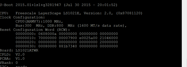

jasonhendrix
Contributor V
Am I using processor rev 1?  How do I tell?  Here is the U-boot banner from my dev-kit:
