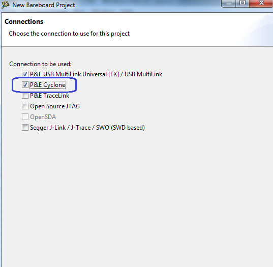

Hi, I have a PE MICRO CYCLONE  fot ARM Devices, is it possible to use it like a debugger (as pe multilink universal) in kinetis codewarrior enviroment?
When I try codewarrior show me only CYCLONE MAX.
Thank you.
Stefano Manca.

Thanks a lot for contacting us.
Could you please update to CW v10.6? This version supports P&E Cyclone for ARM, please see the attached screenshot for the emulator selection in new project creating.
In addition, the license for CW10.5 should also work well with CW10.6.

Hi Everyone,
Please note that the Cyclone for ARM stand alone programmer is currently NOT supported by Codewarrior. It will be supported by Codewarrior v10.6 Update 2.
Johnny
