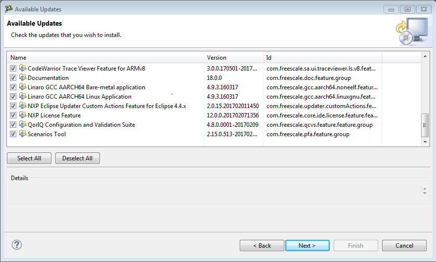

Hi ,
I'm clicking on Check for Update, responds No updates were found but there is a version 11.2.3.
I assume that there is no connection to update server. What could be the problem? What is there a way to upgrade?
Thanks!

addiyi
The Check for Updates works fine (maybe there was some network issues).
But, note that using Check for Updates, the updates is not performed fine. You have to use Help > Install New Software and choose ARMv8 Eclipse Update Site - http://freescale.com/lgfiles/updates/Eclipse/11.2.0/com.freescale.armv8_win as Work with update site.

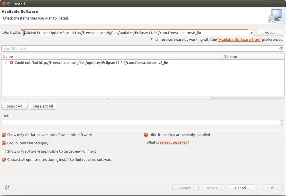

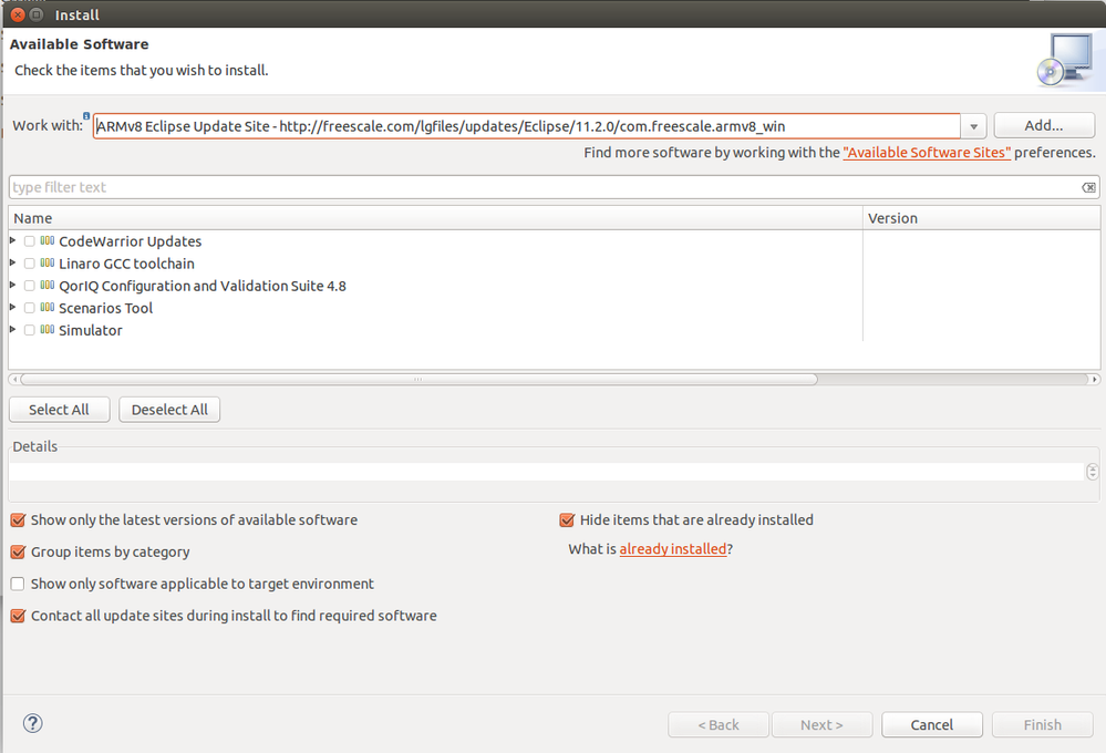

maxprakapovich
Thanks for response.
I forget tell my platform is Linux.
Link for Windows:
Link for Linux:

addiyi
Update site was fixed.
Adrian

addiyi
Indeed there is a problem. Thanks for point it out. It will be fixed is short time. Meanwhile, you can contact your FAE representative for offline package.
