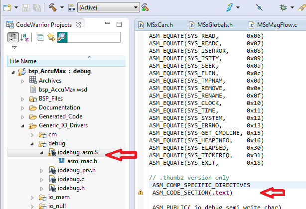

I have K60Tower board: _K60P144M150SF3RM, with MQX4.2 version, and CodeWarrior 10.6.4 Version
I haven't recompile my project for long time.  And something might have modified. But Compilation I got the following warning:
Is that OK?
What caused this warning?
Thank you,
David Zhou

ZhangJennie
Hi David.
Generally, the warning "ignoring changed section attributes for .text" is because user tries to define changeable variable in  .text section. the gcc compiler tries to writable access it, but .text was readonly implicitly.
I didn't see your code, if this can't help, please create a demo project for your issue. I will look into it further.

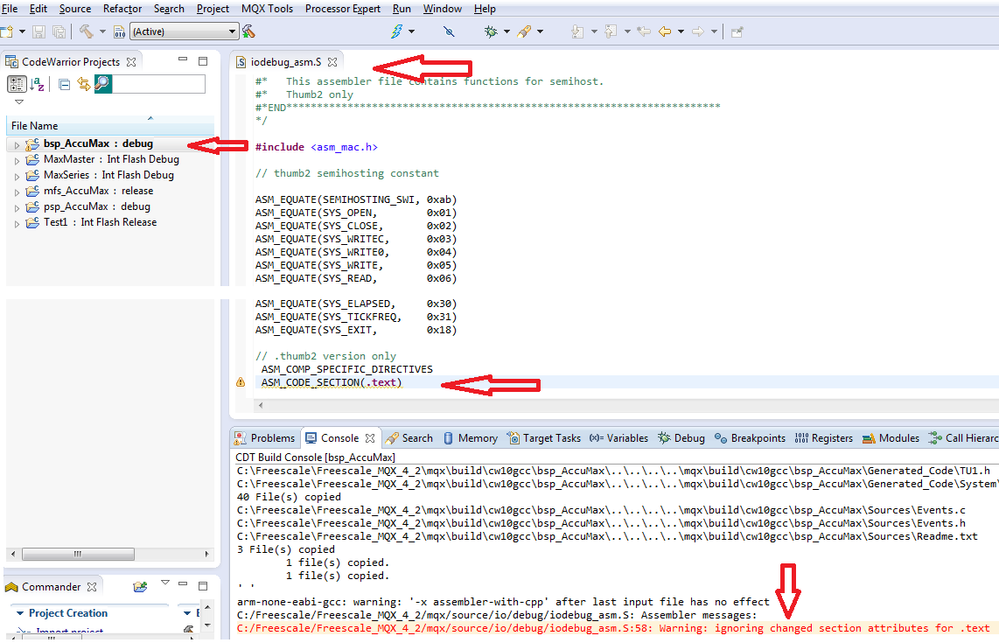

Hi Jennie,
Thank you for your input.
The warning message is from bsp project, not from my application project. In the IOdebug_asm.S file, line 58.
To build bsp_AccuMax in release, it still shows the same warning message. I guess I can ignore it.

Hi Jennie,
I found:
Arnaud Lacombe - Re: Problem for using __attribute__((section(".text")))
and edited iodebug_asm.S file as posted by Arnaud. and warning disappears.
the file location:
C:\Freescale\Freescale_MQX_4_2\mqx\source\io\debug\iodebug_asm.S
