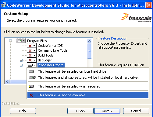

HI,
we can install part of CW feature by custom install. choose custom install, then disable the feature that you needn't install:
CW6.3 is a very old CW product and it isn't designed for win10. NXP doesn't have systemic test of CW6.3 on win10.
so NXP doesn't recommend user uses CW6.3 on win10 and can't provide support of CW6.3 on win10.

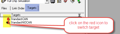

When you want to create the abs or abs19 files with different features depending on the define of something you can use different targets
for example
word variable;
if you want to have different version of your abs the first one with
variable = 0x01;
and the second one with
variable= 0x0f ;
you can create a new target with an ohter name cloning tha standard target and in the compiler you can define a name as you want for example _BIS_
in the project you can write
#ifdef _BIS_
variable = 0x0f;
#else
variable = 0x01;
#endif
if you change in the new target in  the linker application the name of the abs file ,when you compile the two targets in the BIN folder you will have two 6 files 3 for the standard target and 3 for the clone .

" HIWAVE.EXE" is necessary for the CW install.  To guarantee the  completeness of the CW6.3 install, I suggest you install your CW6.3 to a 32bit xp/win7 computer then copy the install folder to your disk. then test your connection again.
regarding to your second problem, I suggest you read
How to support multiple targets in CodeWarrior(Classic, Eclipse)/KDS
chapter 1 is for classic CW.
to switch target, you need click on the red icon in Target tab
