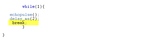

while(1){
echopulse();
delay_ms(2);
break;

ZhangJennie
Hi.
I don't know why you add "break" in while loop.
please remove it thus your code can continue to run.
Jennie Zhang

ZhangJennie
in your original code, you add "break"
thus after execution "break", your program goes to the end . then you will see "illegal BP" message.
when we burn a program into a chip,  we usually need it run until power down. if you add a "break", the program will execute for only once, practically we never do it.
Jennie Zhang
