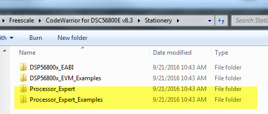

  I have recently bought 56F83EVM kit   PN:CWX-568-SE  I have installed  it.
Does it need to licensing & activation ?
  I can not access to (processor expert example stationery)  so I can not find sample programs . what should i do ?
thank you

Besides Stan,  processor expert example stationery demo code can be found under
C:\Freescale\CodeWarrior for DSC56800E v8.3\Stationery
Jennie Zhang

You installed Free Special Edition version of CodeWarrior that limits some features + code size. It does not require any activation or license. It has limited features.
You can try to download and install the evaluation version - 30 days without any limitations (Professional edition):
http://www.nxp.com/webapp/swlicensing/sso/downloadSoftware.sp?catid=CWX-568-EX
