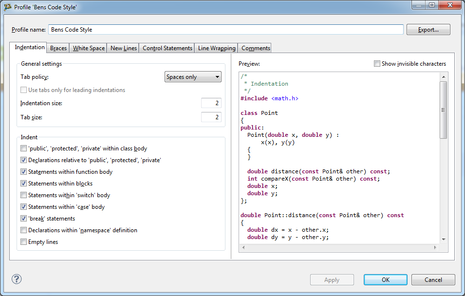

Unless I'm doing something wrong I think I've found a bug in Code Warrior, when using Auto Indentation
My indentation options (in Window/Preferences/C/C++/Code Style/Formatter/Edit/Indentation) are:
Take a simple switch statement (I've used a dash to indicate a space below):
uint8_t var;
switch (var)
case 1:
--perform_action_1();
--break;
case 2:
--perform_action_2();
--break;
I want the case statement to start same at the column  as the switch statement (as above). Typing the code above produces correctly indented code. However if I add parenthesis around the case statement expression (i.e. case (1) : instead of case 1:)  changes the indentation to:
uint8_t var;
switch (var)
case (1):
----perform_action_1();
break;
case (2):
----perform_action_2();
break;
I can't see anything in the code style formatter options that should cause adding parenthesis to result in thiis crazy indentation.
So:
  1. is this a bug or have I done something wrong?
  2. If it's a bug what's the process for reporting a bug?
As an addendum this same issues is present in Kinetis Design Studio so the problem may be with Eclipse.

Jennie,
I want:
case 1:  // No Parenthesis
  function();
  break;
to have the same indentation as:
case (1):  // Parenthesis
  function();
  break;
When in fact adding the parenthesis appears as:
    function();
break;

Hello Ben,
I have reproduced your problem.
I will contact development team for it.
If I get any news, I will let you know.
Thanks for bringing the problem to our attention.
