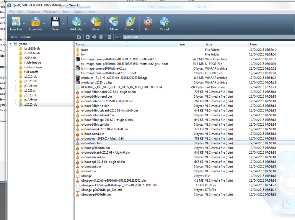

Where can I find bin files for p series and t series of qoriq processor viz p2020 and t2080

Hello Monali Haware,
Please download QorIQ Linux SDK 1.9 prebuilt image ISO QorIQ SDK V1.9 PPCE500V2 IMAGE ISO from Previous version link from Linux® SDK for QorIQ® Processors|NXP, please use u-boot image in p2020rdb folder.
For T2080, please download SDK 2.0 prebuilt image ISO QorIQ Linux SDK v2.0 PPCE6500 IMAGE from Latest Version link from Linux® SDK for QorIQ® Processors|NXP, please use u-boot image in T2080RDB folder.
In addition, for custom boards bringing up, you could download and install CodeWarrior for PA 10.5.1 from CodeWarrior Development Studio for Processors|NXP, then create a bareboard project, build and running the elf on the target board, you could select the SRAM launch configuration when create the bareboard project to avoid configuring DDR controller.

Hello Yiping,
1. I downloaded and extrated the iso file. But it shows .bin files sizes as 0kB. snapshot attached.
