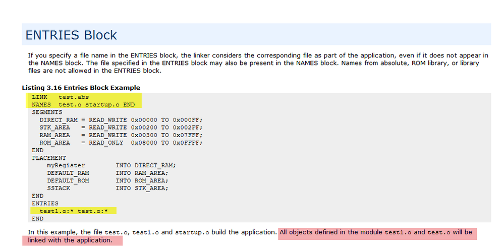

ZhangJennie
If you specify a file name in the ENTRIES block, the linker considers the corresponding file as part of the application. see below snapshot from help manual.
Hope this helps!
Jennie Zhang

scottm
Senior Contributor II
Yes, but that doesn't actually accomplish what I need to do.  The file names aren't known in advance, either.  Your method would also eliminate dead stripping of unused functions in what might be a large driver with more functions than the application needs.
For the Kinetis and Coldfire products that I use this technique with, I can add peripheral drivers by simply adding a .c file to the project.  If I want to exclude support for certain peripherals in a particular build, I can do that in a makefile or through the build configuration in Eclipse.  Without this ability, I have to edit the application and add conditional compilation blocks.
If the compiler supported the __COUNTER__ define I might at least be able to use that to construct a list of function pointers in memory using the @<address> syntax, but the HCS08 compiler doesn't seem to have an equivalent.
I could also implement a workaround as a custom build step with an external script, but last I checked, custom build steps are completely broken in CW10.6 and there's been no word of a fix.
