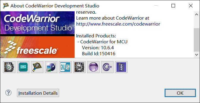

it can't automatic load the usbtap drive in windows10 OS(x64) when i plug in the usbtap. the codewarrior version is as follow pic:
i also try to manual load the drive which searching the whole Freescale folder, but still can't find the right driver.
does someone has the same problem?
what should i do?
thanks a lot.

CodeWarrior for MCU v10.6.4 is not verified under support Windows 10. It only supports:
Microsoft® Windows XP 32-bit and 64-bit (Professional Edition)
Microsoft Windows 7 32-bit and 64-bit (Home Premium Edition and Professional Edition)
Microsoft Windows 8 32-bit and 64-bit (Home Premium Edition and Professional Edition)
For details, please review this page:
CodeWarrior for Microcontrollers-Eclipse IDE|NXP
