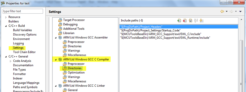

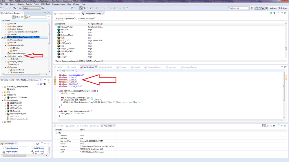

I see there are some project headers missing in Code Warrior V11. How can introduce a path that has the headers?
Some people recommended this:
In order to add additional include paths to your project settings follow these steps.
   - Open the project Properties dialog
   - On the left hand side of the dialog select "C/C++ Build" -> "Settings"-> "Input"
But I cannot find it. I put some relevant pictures here:

ZhangJennie
Hi Bee,
Please set project path in  GCC C compiler, Directories. see :
Jennie Zhang

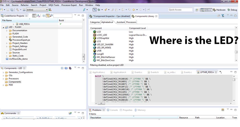

beezee
Thanks for your response. I found that the reason some header files are missing is related to the fact that I used an example, which had components which are missing in my CodeWarrior. For example, I cannot find LED or WAIT components. I read about refreshing the page or update the softeware but those did not help. I put some pictures to support my explanation.
2.png1.pngDo you know how can I add these components?

ZhangJennie
Hi Bee Zee
I think you should refer to the Components that developed by professor Erich Styger. these component should be downloaded from SourceForge, see article.
McuOnEclipse Components: 12-Mar-2017 Release | MCU on Eclipse
