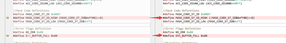

I'm trying to run the sample code from document AN3034 "Using MSCAN on the HCS12 Family". The code is in document AN3034SW. Both of these documents are provided by NXP.
I did modify an include statement and the pragma Link_Info so that it matched the development board I am working with, the MC9S12DG256 development board.
I tried to compile the code and I am getting "Error C2801 ';' missing", but it seems like I have all of the appropriate semicolons. It is also strange because the error happens on 4 very similar lines of code. It is during the CANInit function that this occurs. The CANInit function is shown below. The full code is attached. The code that I copied and minimally modified is from AN3034SW. The lines causing errors are in RED. They all cause the same error: "Error C2801 ';' missing". I am using CodeWarrior 5.9.0.

  CAN0IDMR0 = MASK_CODE_ST_ID_HIGH; //Accepts Standard Data Frame Msg  ERROR Missing ;?

Hello Rachel,
I have checked your file  , there is some spelling error for macro definition .
I changed them  , please check the attachment .
Hope it helps
