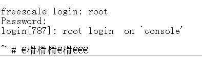

hi
champaka
  I am working on mpc8313 board and code warrior v8.8. when I run the example program say hello world program, the program compiles, gets downloaded to the board and executes. But I  saw something incorrect output  on my hyper-terminal. what’s wrong??

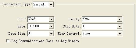

I have made the Serial port setting both on the terminal and the Freescale CW the same :
the output on the terminal:
the programe is just a helloworld:
printf("Hello World !\r\n");
can you what's wrong ?
thank you

Freshman
hello
i have just done as the 8313_RDB_Readme.txt:
Data rate :115200bps
Number of Data bits :8
Parity : None
Number of Stop bits :1
Flow Control : Hardware / None
bin
5,514件の閲覧回数
CrasyCat
Specialist III
Hello
That is strange.
I created a project for 8313 RDB board and the connection settings are as follows:
    Baud Rate: 57600
    Data Bits: 8
    Parity: None
    Stop Bits: 1
    Flow Control: None
I am running CodeWarrior for Power Architecture V8.8.5.
Can you try with this configuration?
CrasyCat
5,514件の閲覧回数
Freshman
Pefect ! it is so strange ! thank you , CrasyCat ! The output is right !
