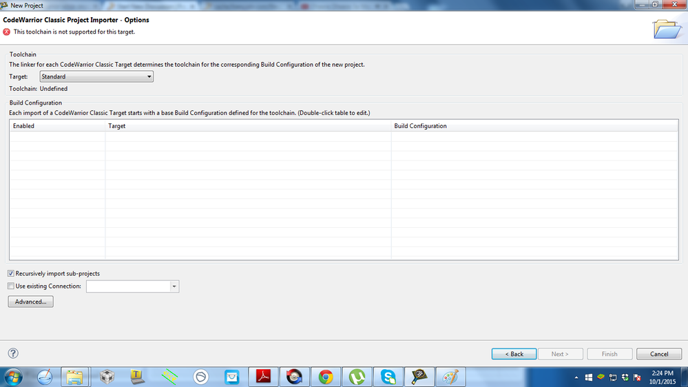

I'm trying to import exiting .mcp project file (demo project given by freescale).
its giving the "this tool chain is not supported for this target" error.
what could be the issue???
print-screen of error is bellow:

This feature is supporting DSC project only.
For other devices, you can not use it.
Application note to import classic project under Eclipse
There are 2 ANs explaining the process depending of the architecture used.
        AN4727, Import project from CW classic to CW MCU v10 4 CodeWarrior for Microcontrollers v10.4
                        http://cache.freescale.com/files/soft_dev_tools/doc/app_note/AN4727.pdf
        AN4104, Converting ColdFire Projects to CodeWarrior Development Studio for Microcontrollers V10.0
                        http://cache.freescale.com/files/soft_dev_tools/doc/app_note/AN4104.pdf
hope this will help

You can import a project in a workspace via the  menu:
    File + Import...
          General + Existing Projects Into Workspace
              you can select the project you want and recommend to select the option" Copy projects into workspace" to have all files under your workspace.
