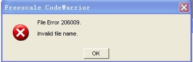

Freshman
hi
     When I creat a project in CW8.8 ,  I meet the problem as the follows:
who can help me ? and I just do as the user manual !

CrasyCat
Specialist III
Regarding the issue with File error 206009, did you check following post in the forum?
CW 8.8 file error 206009 when creating new project for P1020RDB
Regarding the linker issue, did you create your project using the wizard?
Is there a file __ppc_eabi_init.c in your project? This is where the function __init_hardware is implemented.

Freshman
tahnk you very much @CrasyCat , i am too careless to see the fomer answers.
