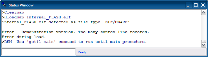

error-demonstration version.too many source line records.

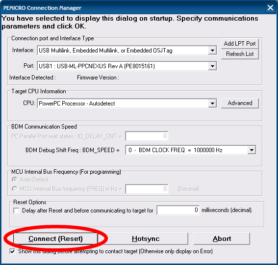

I am using codewarrior for MCP55xx/56xx V2.10. And i debugged a project and connected into the MCU(MPC5644A) like picture 1.
At last this error appeared like picture 2.
It seem i can only download 5000 line source line records.
If i want to load more source line into the MCU,what should i do.

You're using MPC55xx/56xx V2.10.
There is a Debugger issue with MPC55xx/56xx V2.10 too similar to CW for HC12 V5.1
Officially the USBDongle is not working on Win7 for Classic IDE.
We recommend to rehost the license file to Disk/Host ID.
Now if it's not an option we can propose you a workaround:
    add an additional key for Win32_Plugins_Link_PPC
