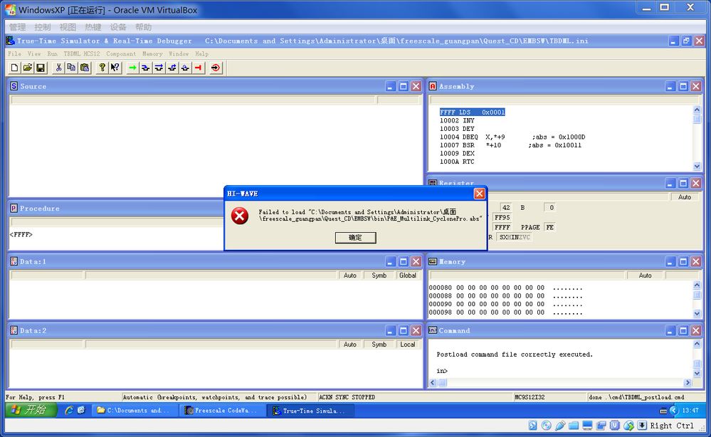

    How to deal with the problem, al following:
the device is MM912F634
Best regard!
Guofeng Lai

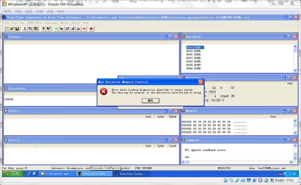

ZhangJennie
Hi Guofeng
If use 32bit xp,from first screenshot, your chip is secured.
On the debugger go to the menu TBDML HCS12->Unsecure...
This will run the "TBDML_Erase_unsecure_hcs12xx.cmd" file.
please check if your chip can be successfully unsecured.
if Unsecure can not fix the problem, try create a brand new project, test if the new project can be downloaded.
If still can't connect board, please test your board with another interface to verify if the chip itself has problem.

guofeng
Hi Jennie,
   Thank you for your response.
   The project is built on 32bits XP platform. and I have downloaded the program successfully before. Is there something wrong in the IC?

ZhangJennie
Hi Guofeng
